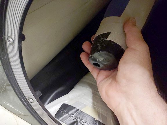

We just had the exact same thing happen to our 13 year old i14t. I read in another part of the forum where someone cut the skin on the top to repair the leak and then patched the skin. Not wanting to do that I procrastinated. Took the hatch off to try to get to it, pulled a vacuum in the center chamber for more room and the nose piece popped off the top and fell to the bottom where I could get to it and re-glue the two seams that had dried out and opened up. That nose piece goes in the top center screw with two loose keepers on either side to hold it. Our top hose was always off center (turned) because the hose that goes up in nose had a twist in it, doesn't now that I put it back after figuring out how it worked.
