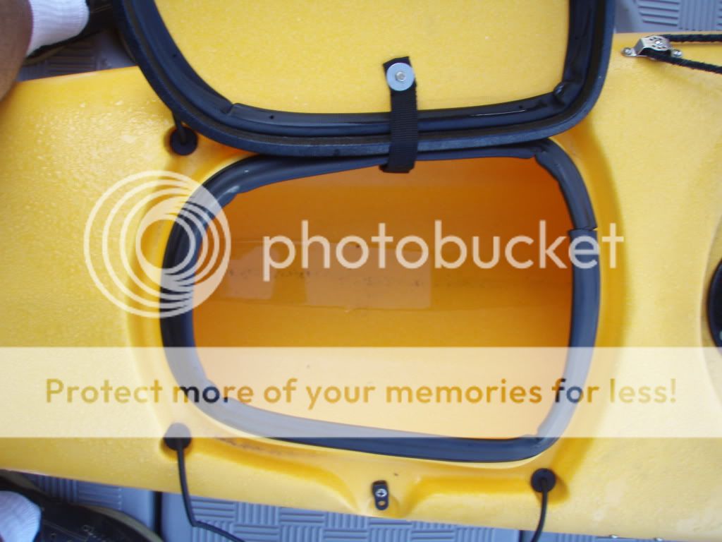

I had the same problem on two AI's. After trying the Marine Goop, Super Glue, and a couple of other solutions, all of which fell off again, I replaced the gasket entirely. A friend of mine works in the Automotive Glass industry, and when he looked at the peeling original gasket he pulled out his auto glass supply catalog and pointed to a solution. The catalog is from a company called C. R. Laurence, and the gasket materials were part numbers CRL ST29A, Push-On Vertical Lip Trim Seal, and CRL ST36A, Black Bulb Trim Seal. One is for the part on the hatch cover, while the other is for the part on the hull. These are somewhat thicker than the original, but unlike the original Hobie gasket, where the gasket tubing is only glued to the mounting portion, the gasket on these are molded into the mounting channel. I only did the replacement at the end of August, so while it is still too early to know how they hold up over the long haul, I think it'll work out. Ordered from C. R. Laurence, they come in 25 ft rolls, and cost me around $2/ft. This looks to be enough to do about four boats. These items might be available from other sources, so maybe you can order them in smaller quantities.
I'll post some pictures of the installed gasket later this weekend. Have to get the camera and get out to where the boats are currently stored.
- Jim L

Finally got a chance to take a couple of pictures of the new gasket. I'm not much of a photographer, but here they are...
OK, how do I post pictures?
- Jim L

OK, let's see if this works...

Looks a little bulky... But if it's bombproof, who cares!
