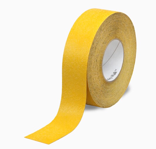

To address the slippery surface on the top of the back-boards, I'm gonna try some of this, and see if it stays on:
PostPosted: Thu Sep 25, 2014 3:08 pm
Posts: 3068
Location: Kailua 96734
YES! Whew! :roll: Thanks Bob.
Is this gorilla type tape?

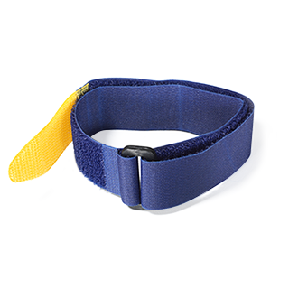

If you can't get rubber pads to stay glued on the plastic, I might try neoprene sleeves on the Akas. You could use any type (wetsuit material, kayak paddle grips, wine bottle carriers, drink cozies..) Ask Dee to sew some Velcro on them, to wrap around the bars.
In the good old days, (pre Haka) I used to wrap closed cell pipe insulation on the Akas with one wrap Velcro and sat on these.
If she's not in the mood, they make straps like this for marine use:

3M makes a bunch of Anti slip tapes. I've had good experiences with their adhesive products.
