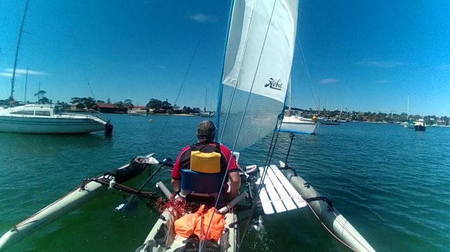

I lifted the mount 50mm by adding another section of post tube underneath. After another 10 hours of motoring covering nearly 80km I am happy with this setup. The extra height makes it is much less prone to getting hit by waves, especially when heeled over.
The turnbuckles needed lengthening so I added shackles. This worked but also added weight so I went to a more conventional bracket type setup using u-section aluminium.
The bracket weighs 2.6kg and can be removed easily by undoing 2 eyebolts, a quick release pin on a turnbuckle and a wingbolt.
I have been really enjoying this outboard on the TI. As has been said, the touring range has been greatly increased. We are now able to access spots that previously used to take days to get to. Motor sailing in light winds is easy.
It has a shallower draught than the pedals and works well in water too shallow for the rudder. It is also a great benefit when the wind is really strong. I've taken to motoring into a strong wind and then sailing back.
Here is a mix of clips: motoring, sailing and motor sailing.
This outboard just adds so much to an already versatile craft. The only downside really is the noise but this negative is outweighed by all the positives IMHO!
