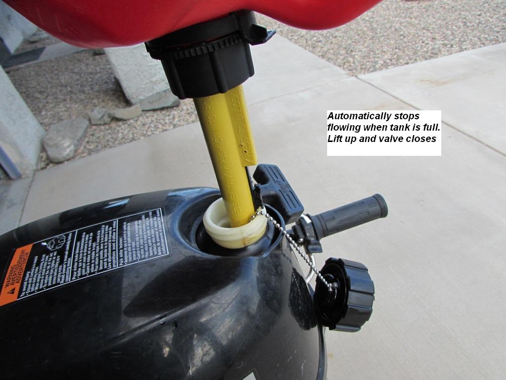

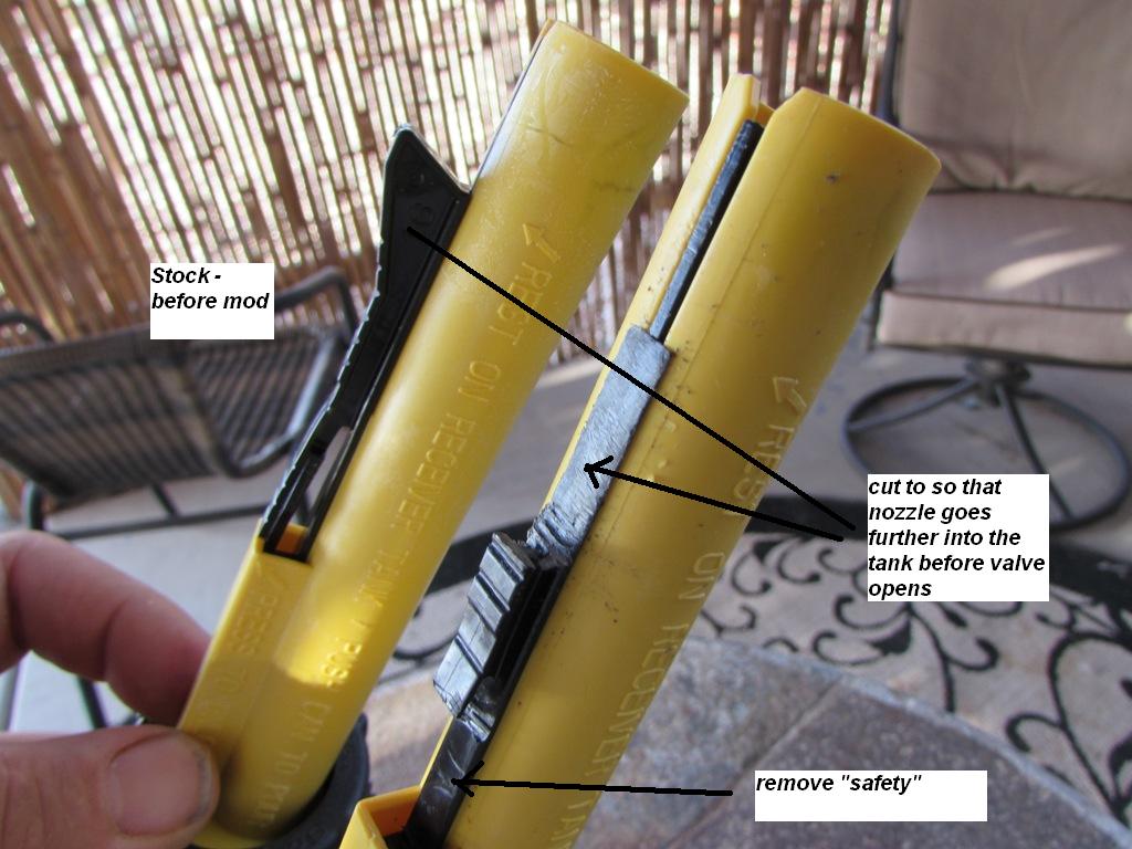

A little more detail on one method to re-fil one of these small outboard gas tanks..
I have tried 20 oz bottles for re-filling the tank and these work but you really need a funnel. I have tried a few other things but what ended up working fairly well is shown below.
Its based on a one gallon gas tank with this "auto shut off" or spill proof feature https://www.lowes.com/pd/1-Gallon-Plast ... n/50077793
This tank gets some poor reviews because of all the safety junk built in but when modified.. really works nice. The tank has a valve that opens when the nozzle is pressed into the tank to be filled and the flow automatically stops when the gas level reaches the tube. However, I found that it would come too close to overfilling and sometimes overfill so I modified the nozzle so that it would go deeper into the tank before the valve opened and also automatically stop at a lower level below the top of the gas tank.
I can fill the tank on the water without spilling a drop. Install the nozzle, press the nozzle into the tank opening the valve.. count to ten (it takes about 7 seconds for the tank to fill), then slowly lift the nozzle out of the gas tank. Doesnt spill a drop.. If Im on a long motor run, I just fill the tank once per hour.
FYI, I saw someone using a fuel hand squeeze pump (the pump in the fuel line on most outboards with an external tank) to fill one of these small tanks on the fly but didnt get to see the details.. It seemed to work fine also. I suspect you have to be careful not to over fill and spill.

Very cool Walt! I must find one of those to replace my 2 litre aluminium bottles and small funnel. With the latter, it is very hard to judge the amount going in so as to avoid overfilling...
