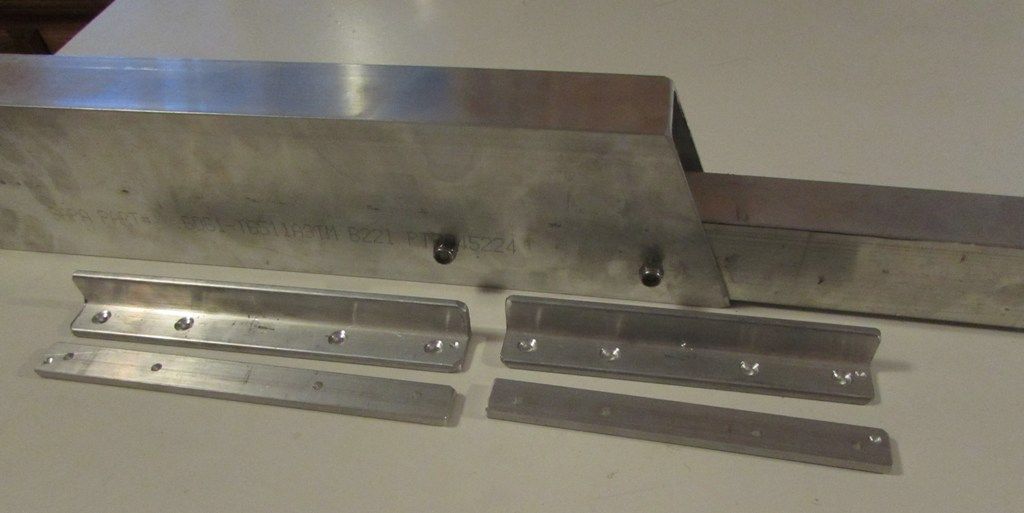

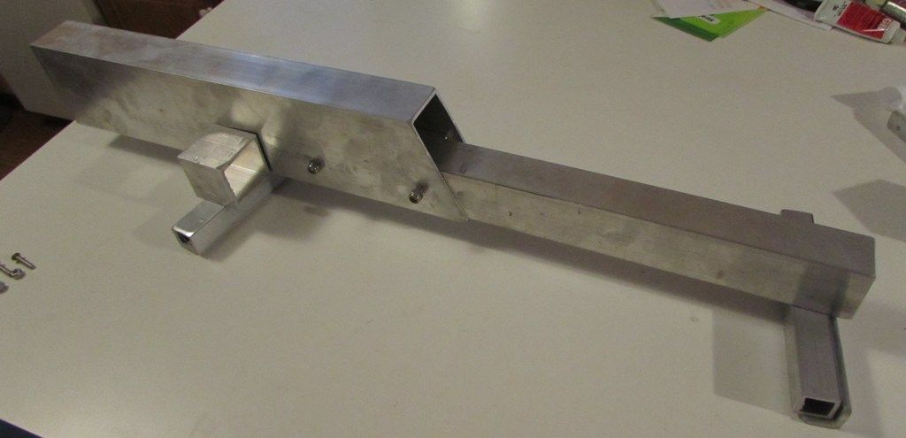

So below some picture of the mount installed. Well, almost. I still need to decide the location and height of the transom plate. My plan to have the motor as close to the hull as possible may not work. If I want to be able to steer the boat with the motor in case of a rudder failure, I will have to drop the transom plate lower for the prop to clear the hull. That may create drag and waste of power. Putting the motor too closer to the hull interferes with the cart if I want to put it right behind the seat in the scupper holes (which I do). Installing the screws so far into the hull was a bit@h. I had to remove the rear hatch to get a little more access.
Here are some questions I have before finalizing the install just to find out it was a mistake while on the water;
1) How deep should the prop be? Following stringy's install, I started high at 9.5" over the gunwale. Below I posted a picture of the prop in relation to the bottom of the TI. I think I may have gotten the long shaft. The seller told me he had both options. I opted for the short, but there's no way for me to know what I got. I measured 27" from the underside of the motor cover to the lowest point under the prop. Can any Suzuki owner measure his motor for comparison? Should I lower the motor? Look like it is safely below the water line.
2) Does having the motor a little away from the hull can result in a pull to the side or any adverse effect anyone know of?
At it current height, the motor sits right next to my head. I believe lowering it would ease the noise a little but would it create drag?
I am anxious to complete this and move on to my next project. Spring is around the corner and I want to be ready...

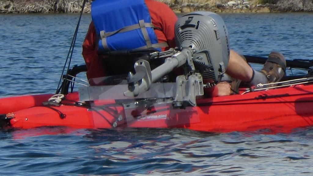

One thing to tests.. Remember that the force from the prop thrust makes the boat go nearly as fast as the sail does. Think of the force on the sail in all that wind, its significant.
One little test you can do. The force from the prop thrust of course is at the prop so push on the prop with a fairly rigorous force. This creates a twisting torque on the mount. If all that metal is twisting when you do that.. it might not be strong enough. You can compensate by adding the tether from the shaft of the outboard to somewhere on the back of the boat like FE mentioned.. but if the mount is rigid enough, you dont need that tether.
Not everyone uses the outboard this way but mine is usually folded up (prop out of the water) when Im sailing and if its windy and wavy, there is 30 pounds being jerked around. Your mount needs to handle that also.

I am confident in the mount. it's a minimally designed tank. It is bolted down via 8 screws going through the hull and a back plate.
