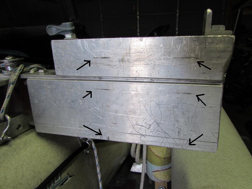

Just an FYI, I took a picture of the side of my mount that the outboard back side (with the tabs) pushes up against. You can see the marks on the AL from the outboard tabs (highlight with black arrows). They dont move at all. One other thing to note about this is that the height of the mount that contacts the outboard rear mounting plate is 4 and 7/8 inch. This picks up all the mounting tabs but the very bottom ones (vertical, the top ones are horizontal) probably could have used a little more top to bottom surface. However, I haven't had any issue at all with this and now have many hours and miles.

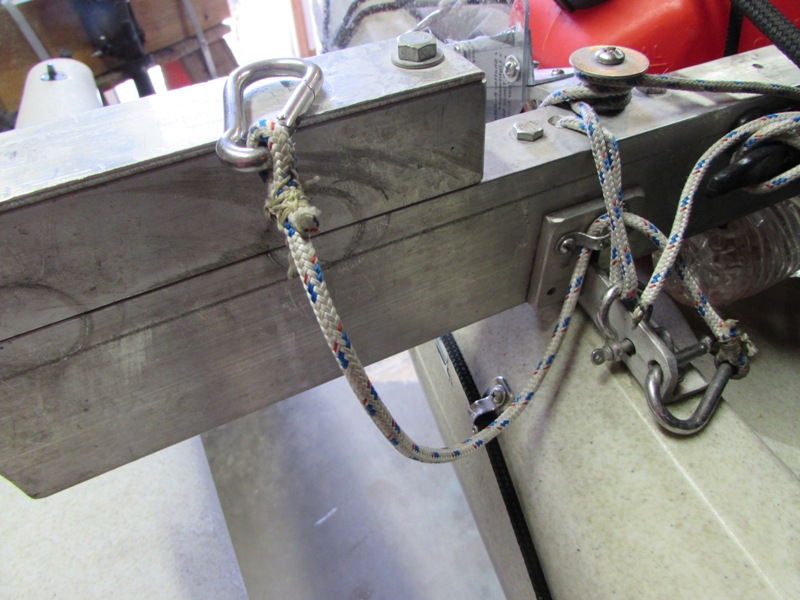

The picture below shows the safety clip - just in case for some reason the outboard came loose. I havent needed it so far but happy its there.

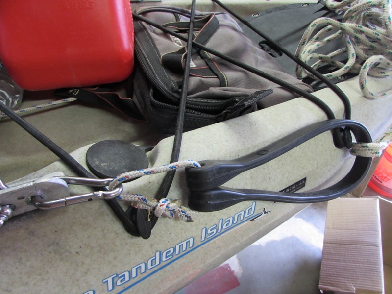

Picture below - my towing strap. I just added the bungee to handle shock loads that can happen when a boat goes by and creates a wake.
