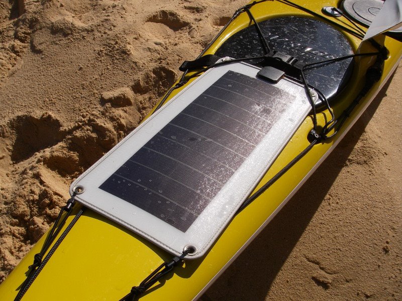

I'd go the bigger capacity solar panel. A lot of the time the specs on the panels are very optamistic and under perfect conditions. Add some cloud and salt spray and you'll get less power out.
These seem to pretty popular for kayaks-
Find more info here-
http://mattbezzina.blogspot.com/2008/10/solar-powered-battery-charger-for-bilge.html
and here-
http://www.roguepaddler.com/battpak.htm
