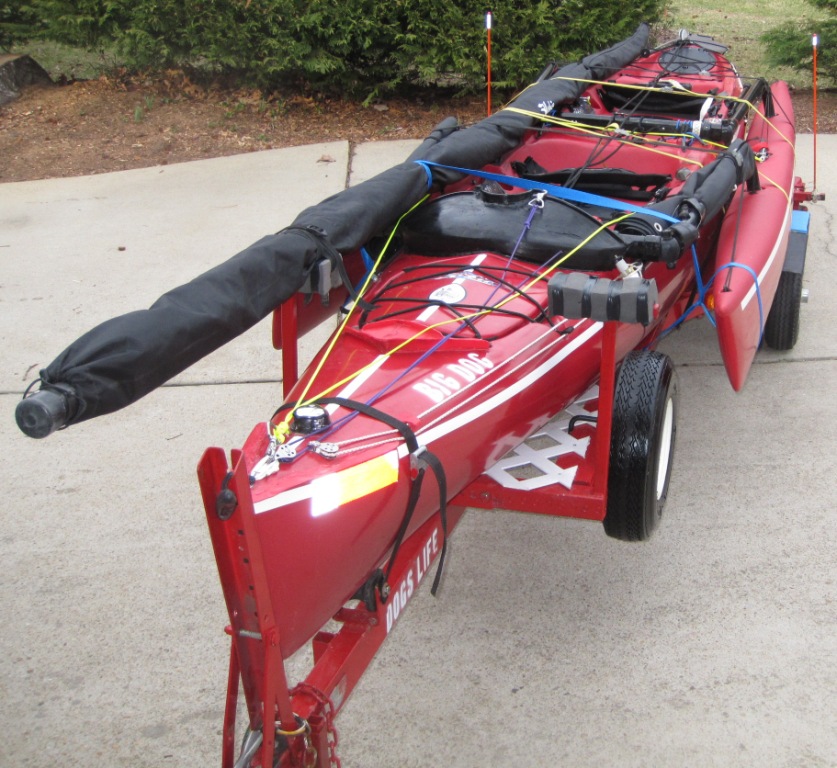

What do you do if you can not change the shape of your bow???
I have been playing with that idea on my TI:
1) I welded small strips of plastic at the bow. They were mainly there to control the spray coming off the nose. Added benefit is that they push the bow wave down and out adding some lift.
2) Once a bow completely submerges it has lost all of its reverse buoyancy. The water pressure on top act to push the bow down further. Second mod is a small hurricane bow in front of the hatch. The shape is pitched forward to throw the the water out to the side.
Both design changes depend on the boat having forward motion. If the boat starts to stall, turn up wind. That always pops the boat back up. Then turn right back and the boat takes off like a bat out of hell. During the EC, I noticed that the new rudder is very responsive for this move.
Paul

OK Keith,
This is my Bow Defletor with the Hurricane bow in the background:
Another view from the top:
And this picture you have seen before showing the whole view:
Paul
DogsLife
2011 Adventure Island

PostPosted: Fri Apr 08, 2011 10:27 am
Thanks for the pictures, Paul.
How well does your bow wave deflector work? Does it reduce bow diving? Or, is it mainly a spray deflector?
I, too, hate water in the hull. I've been able to reduce the amount sufficiently, that I now put up with the 1-2 qts I take on in a typical day on a camping trip.
With your forward bulkhead you have demonstrated that, on your boat, the front hatch does not leak. The front hatch is well-designed and, unless, the seal is somehow compromised, it should not leak.

Keith,
the tabs are not big enough to add a whole lot of lift. They are at the bow tip so it takes less force for positive results. The tabs are curved to push the water flow down. I am sure that the force could be calculated and it is dependent on the speed. It is hard to steer and closely watch what is happening at the bow. Some of my Youtube videos show the bow going through the waves. I am a fairly conservative sailor. I try not to overpower the boat. If it starts to dive too much, I reef. Diving might make great video but it does nothing for the boat speed.
It was because of the bulkhead that I found the problem that I had with my front hatch. For the longest time I could not figure out how the hatch was leaking until I found the two leaking bungee screw plugs. I think that the front hatch will leak if you burry the bow past the hatch. That is a lot of water pressure.
