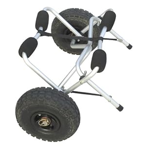

I was more curious how the C-tug supports "fit" the bottom of the AI hull, i.e., would it be usable for a fully rigged AI setup ?
I've got the one pictured below with the baloon tires on it and really dont like how it supports the hull (if I leave the AI hull alone on it for any length of time I get deformation) - plus it won't even fit in the front hatch with the wheels off. I can't use a scupper cart as one of my holes was taken out of comission. I usually leave the cart behind but was "stranded" earlier this season requiring my wife to take a ferry ride in the truck to come get me, when If I had a cart on board I could have "tugged" it onto the ferry myself.
