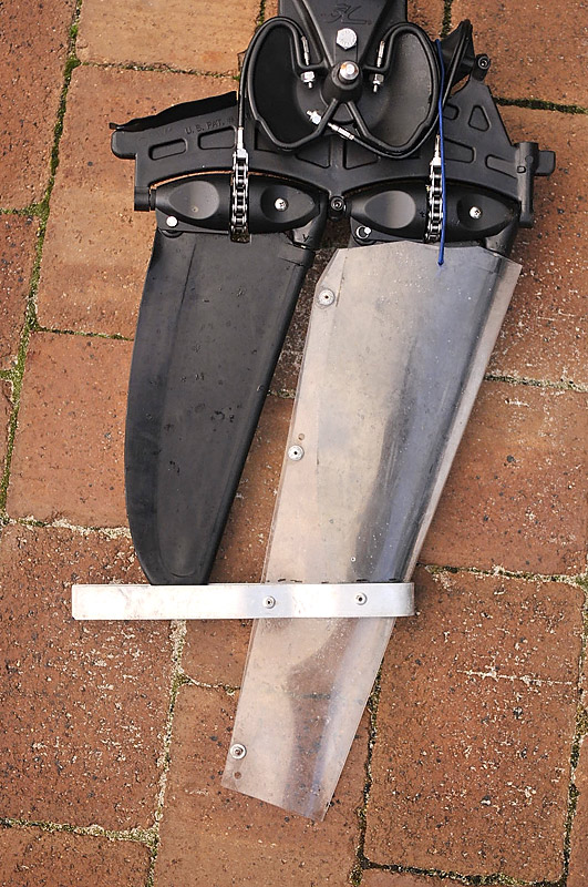

Cheap test, I think I have a line on a sunfish daggerboard that I can modify to fit in the front MD well and lock in place. If I get my hands on it, I will post pictures and results.
Oddly enough while searching for daggerboard I found this:
http://www.akff.net/forum/viewtopic.php?f=58&t=30240
Now THAT is clever! It might be a 5 year old idea, but its a bloody good one!
