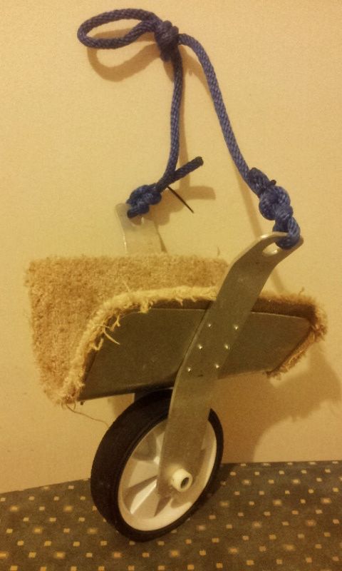

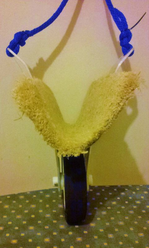

PostPosted: Sat Dec 20, 2014 3:35 pm
Joined: Thu Feb 23, 2012 2:13 am
Posts: 14
Here is a simple design which might give you another idea?
This does not turn, but is fine for a straight line.
Its actually for my AI, but could equally suit a TI.
The aluminium plate is shaped to follow the contour of the hull.
You just slip it over the bow & it sits there quite well.
Cheers
2012 AI, Yellow
 Post subject: Re: Third wheel
PostPosted: Tue Dec 23, 2014 5:38 pm
Posts: 426
Location: Austin Texas
Rodnco, nice work, I may end up with something just like that.
Thanks !
