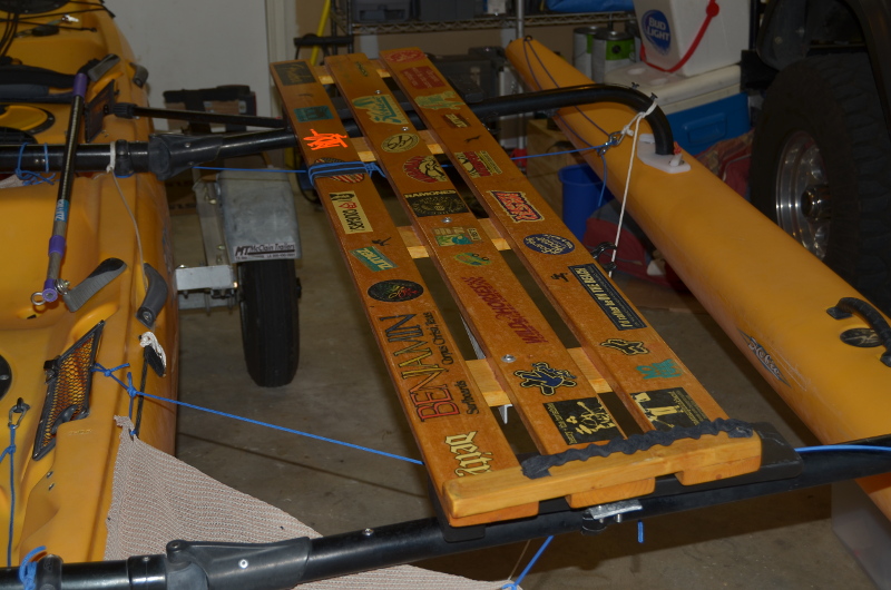

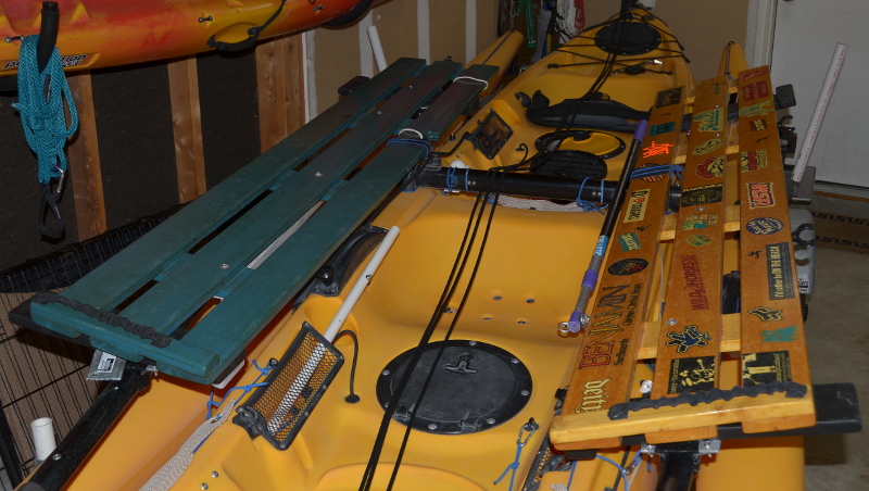

First up is my set of haka benches with pivoting mounts that allow the akas to fold without removal.
Here they are in the folded position:
And here is the port side with the akas extended:

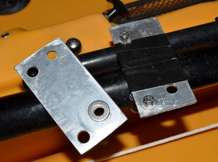

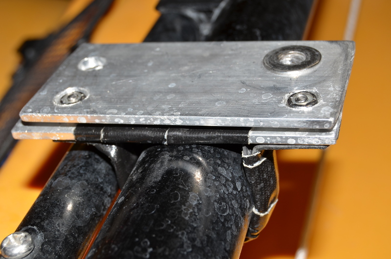

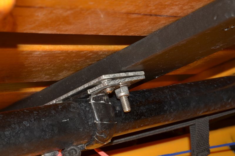

Here's a shot of a mount, which is basically a two hole pipe clamp bolted to an aluminum plate:
The top plate (the plate on the left) acts as a big washer and gives the haka a smooth surface to rotate on. It gets sandwiched between the bottom plate and the haka bench
A 5/16" stainless steel bolt is then ran through the bench and through the mount and secured with a nylon nut.

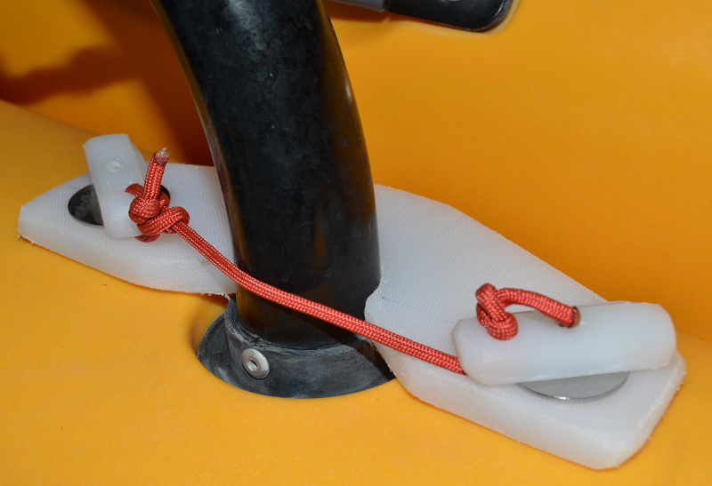

My goal was to minimize time at the boat ramp rigging and un-rigging the boat, which also brings me to my next mod, bungee-less ama retention. This idea came from another member on the forum - http://www.hobiecat.com/forums/viewtopic.php?f=71&t=46952
I basically did the same thing mentioned in the previous link. I made the retention devices out of HDPE cutting board that I picked up at the grocery store. I was going to use stainless wing nuts to hold them on, but decided to try making my own out of the same cutting board. I cut out the "wing nuts", drilled and tapped a 1/4" hole and screwed them down onto a 1/4" bolt that protrudes from the ama bungee fitting.

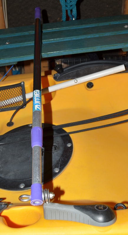

Here a shot of my hiking stick, which is an adjustable broom handle with a 1/4" stainless steel eye-bolt bolted to the end and threaded into the steering handle.

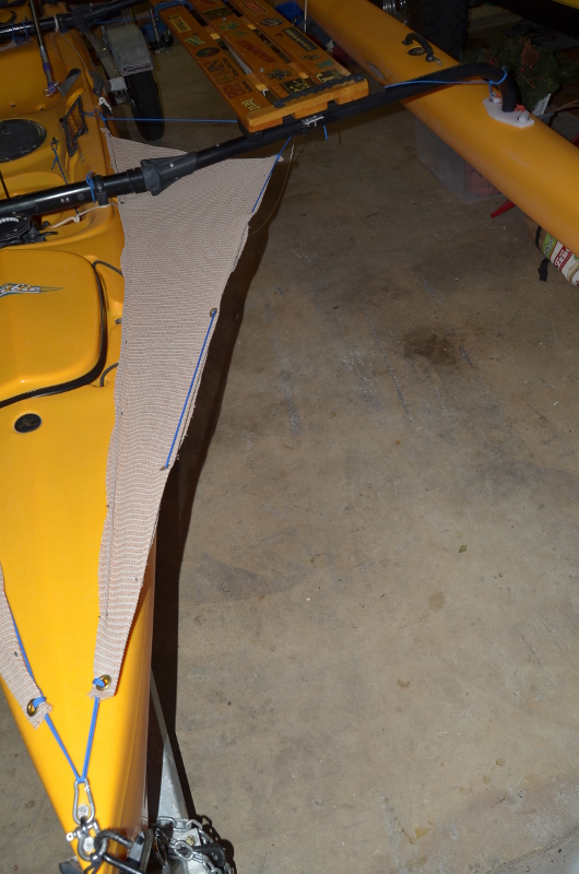

Lastly, for now, are my homemade spray skirts, which are also rigged to allow the folding of the akas without removal.
