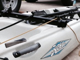

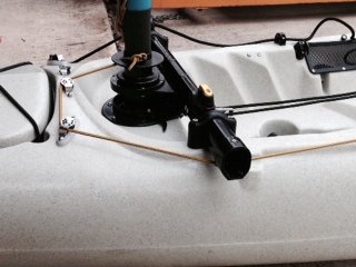

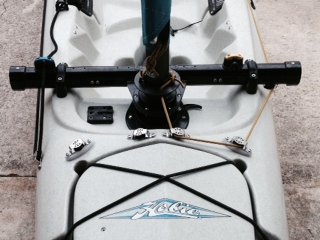

Has anyone ever seen or done this modification? I just didnt like the sharp angle the Furling line came of the barrel and into the cam cleat fairlead, it has also made it easier to furl in high wind.
It is also the beginning of my mod to have a rear seat cam cleat, same as you would in front seat position.. And instead of the furling line going through front cam cleat there would be a 3rd cheek block directing the line under the aka cross mount and there after would be a few more fairleads retaining the Furling line along the left hand port side of kayak to the rear seat furling cam cleat... hard to explain.

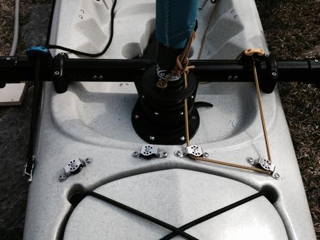

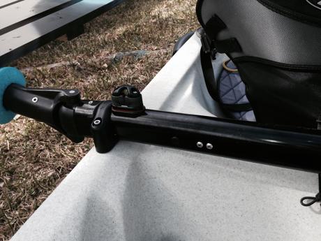

Here are some photos of the rear aka cross mount, with the Furling cam cleat mounted on the left left hand side. I had to drill & tap the holes for this cleat.

We tried several arrangements, similar to yours. You have the right idea stepping down the vertical angles like that.
In the end we decided on this arrangement, which though it looks awkward, creates the least resistance, and never piles your line up or spills it off the drum when you unfurl. It's spray painted RED to match the hull now.
Welcome to the forum Armada.
PostPosted: Wed Mar 05, 2014 12:45 am
Joined: Mon Mar 03, 2014 11:16 am
Posts: 17

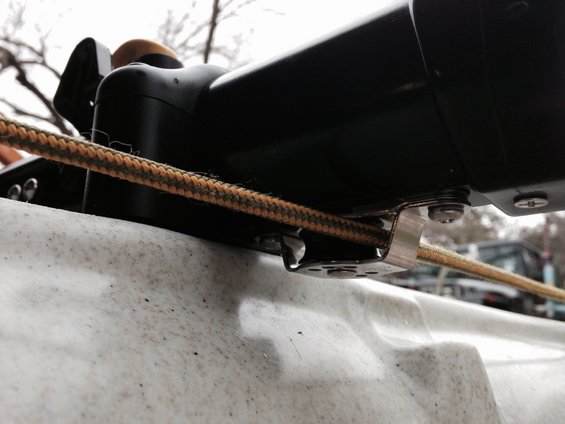

Thanks NOHUHU, I feel honored to have you comment on my post. I have read so much about you, even before I had my TI when I was still researching the Hobie Islands... That being said ...lol.. I know what u mean about the furling rope piling and spilling off the drum and that is why I added the second cheek block centered in front of the drum. It is almost high enough without a spacer and does pretty well, but would be way more efficient with about a 1/4" spacer. I hope to get the rest of the hardware soon to finish the rear seat furling cam cleat mod real soon, this hardware is pricey $$, but worth the Fun!

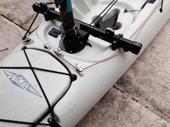

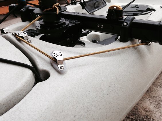

Worked on the Furling Modification some ore today, took Nohuhu advice and made spacers...... I drilled and tapped the holes in the aka cross mount bar for the 3rd cheek block and is mounted to the under side, I had to completely remove the cross mount to do this....

I still need to install the fairleads along the side of the kayak and at least one more cheek block directing the Furling rope into the rear cam cleat.

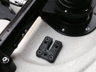

Also installed the Yak Attack Mighty Mount to attach the GoPro, since I had all the tools out.
