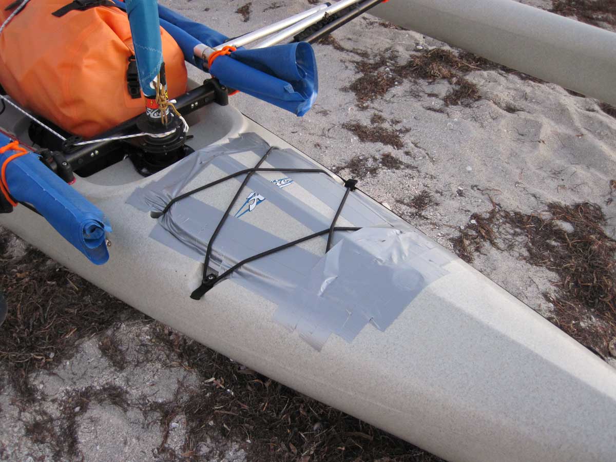

Tom Ray wrote:
I'm not sure whether this dangoltalkinbout hatch modification has been covered in this thread.
Maybe if somebody could get that photo in front of one of the decision makers at Hobie, they'd finally get the message.... -)

PeteCress wrote:
I believe that picture was taken at one of the WaterTribe Everglades Challenges. Personally, I think that fix is ridiculous. There are better ways to fix the front hatch leakage problem without sealing it semi-permanently. Having said that, I agree that Hobie should do more to remedy the problem.

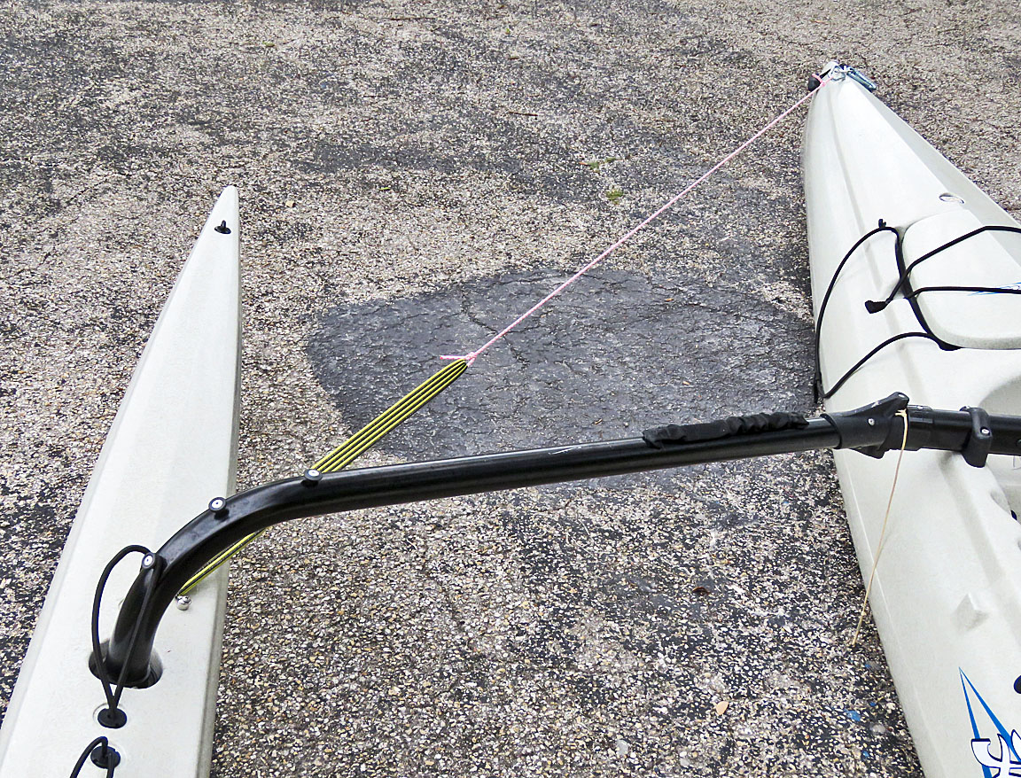

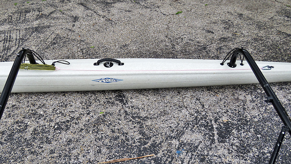

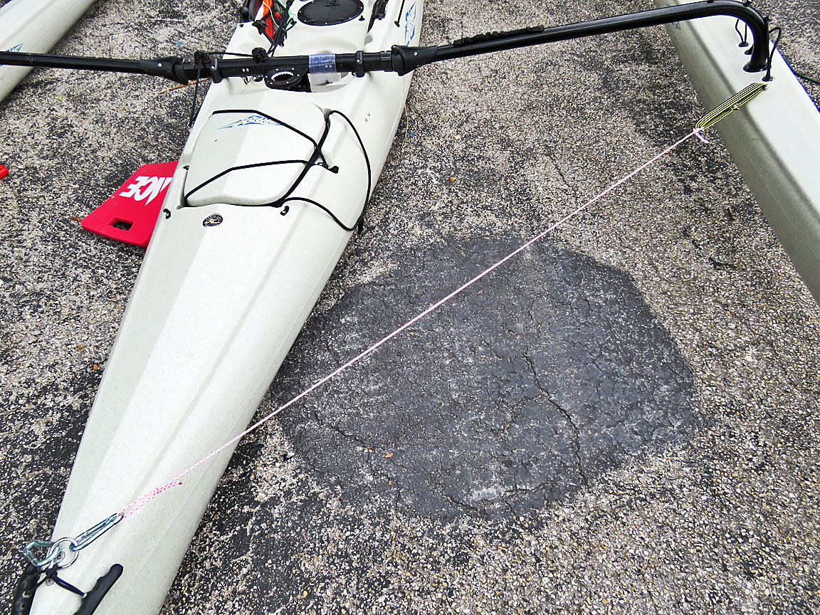

Keep-Out Lines Revisited
Anyone who does serious day trips or multi-day camping trips needs keep-out lines. Any keep-out line which (1) attaches to the hull and (2) angles back to attach to the ama, must be able to stretch to absorb the shock of a collision of the ama with an object. The aka brace pin will break, but the keep-out line will prevent the aka/ama folding back. As Fusioneng has said, even multiple small shocks to the ama will add up to sufficient wear on the aka brace pin to ultimately result in the pin breaking, ama/aka collapsing, and, perhaps, “insta-capsize.” The keep-out lines are designed to prevent the collapse.
My keep out lines are simple: a hard line connected to a short section of bungee cord. The bungee cord provides stretch allowing the aka/ama to fold back and permitting the aka brace pin to break as designed.
This picture shows the shock cord stretched.
You can apply enough force on dry land, to fold the aka/ama back considerably.
When not in use, the keep-out lines are simply stored on the ama.
Those original flat bungee cords did not stand up to Florida sun and elements. I have replaced them with 19” flat, EPDM rubber bungees. Amazon link: https://www.amazon.com/gp/product/B000CCFCO0/ref=oh_aui_search_detailpage?ie=UTF8&psc=1
These keep-out lines have been tested at 8 mph on the water, and they prevent the aka/ama from folding back.

How did you attach the eye straps to the amas?
PostPosted: Mon Jul 31, 2017 8:29 am
Hi Mistermoon,
I just drilled a small pilot hole into the ama and then used a SS screw. I think they will hold anything barring a major collision, like with a piling at speed. They do not leak into the ama.
PostPosted: Mon Jul 31, 2017 11:05 am
Joined: Tue Jul 11, 2017 3:48 pm
Posts: 49
Thanks. I'll take it under advisement. I'm not super comfortable drilling holes in the amas, so I think instead I'll tie the ends of the hold backs to the akas.
Why do you assert that the hold backs must be able to stretch to absorb the shock of a collision of the ama with an object? I need convincing that's truly necessary. I plan to test it with 3/16" nylon (stretchty) and 5 mm dacron (doesn't stretch much) to see what works.
PostPosted: Mon Jul 31, 2017 11:59 am
I have no problem drilling holes in plastic amas. Just fill them with goop or a fat screw. It is plastic and will flow to close tightly around a tight-fitting screw.
Some kind of stretch is necessary. If you use a non-stretch cord, you have a rigid system and the pin will not break transferring the forces to the next point of weakness. At the other end, you have my bungee system, which gives, allows the pin to break, but doesn't allow ama collapse with insta-capsize. In between is everything else.
