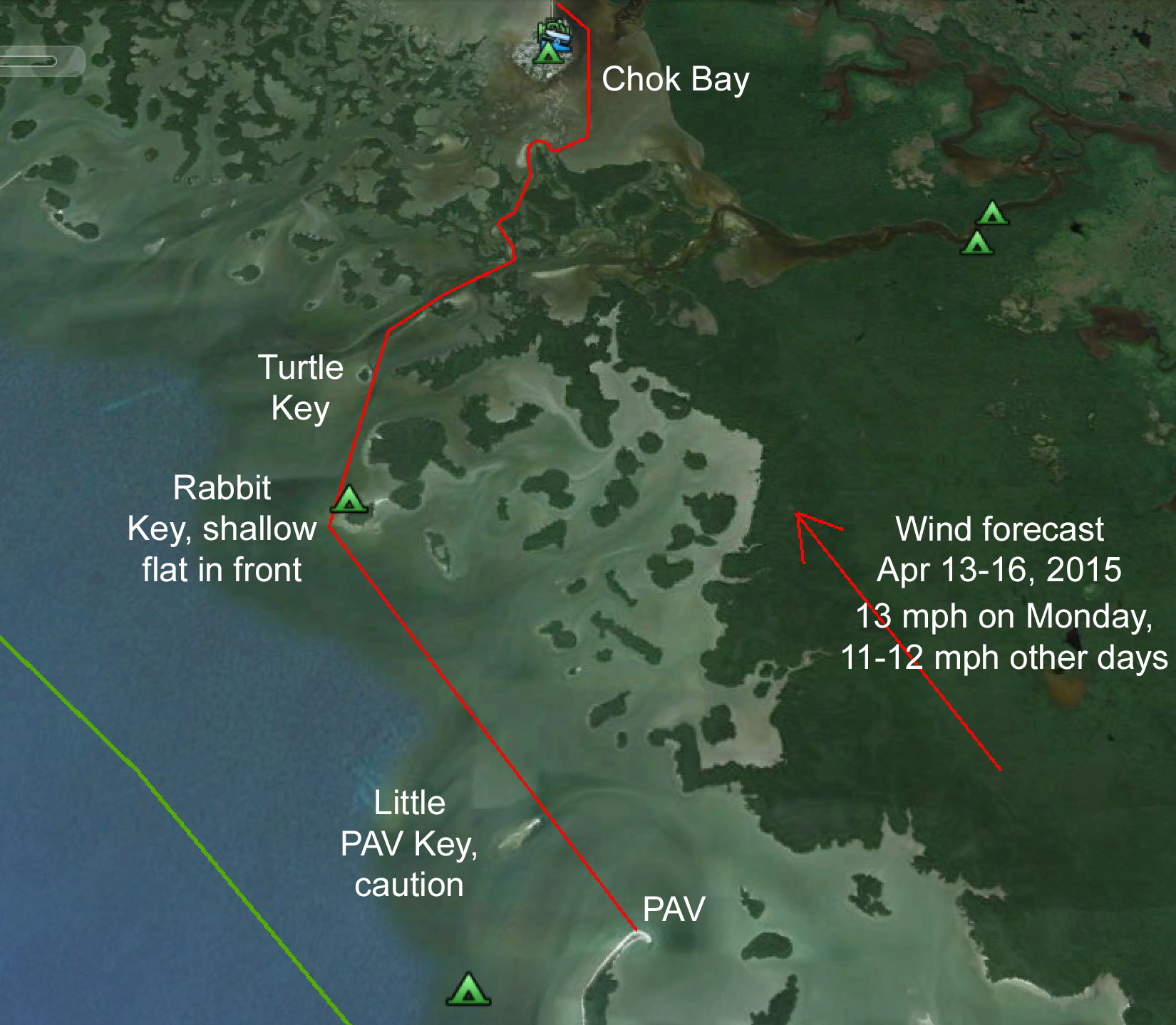

This Google Earth image gives an overview of our route from Chokoloskee to Pavilion Key and the unusual event on the first day of our camping trip. Royd & Alison Whedon in their tandem, Sharon Hutkowski in her AI, and Joshua Morgan in his Kruger with Balogh sail and outriggers had launched first. Tom & Debbie Turner in their Tandem and I in my new 2015 AI 2 left 20-30 min later. We had headwinds as we made our way down Chokoloskee Bay and through the passes. We tacked to the north of Turtle and then headed towards the outside tip of Rabbit. At one point, we both were on a tack towards the gravel bar connecting Rabbit and Lumber. I was surprised to see a Hobie Island beached there. It didn’t dawn on me until we were past Rabbit that it was Sharon.
Tom & Debbie and I sailed south towards Pavilion. The winds were probably SSW at the time, so we were tacking. About a mile and one-half from Pavilion, I decided to make one more tack to the west. Tom radioed me that he thought my tack was unnecessary—he was right, but because of the winds, I did not hear the radio.
On my port tack to the west, I took a few pictures and a video. The pictures & video show that I had a full wrap of the sail around the furler. The seas were rough, but nothing unusual in my mind. Winds were probably about 16 knots (18 mph). Near the end of the video, at about 40 sec in, you can see waves washing over the bow of my AI 2. The picture and the video are a bit deceptive—there were whitecaps everywhere. Both on the picture and the video, my camera had a drop of water on the lens.
