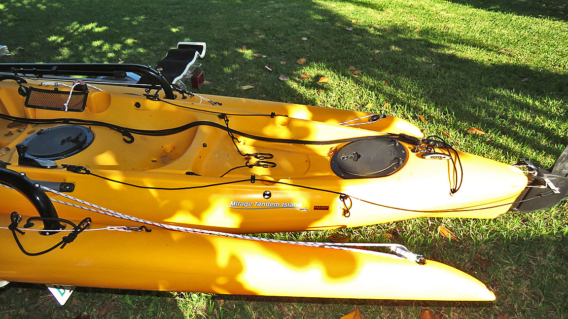

External Rudder Lines
It has always bothered me that the rudder could become unresponsive to the tiller for a variety of reasons. One of the most common is simply that a rudder line slips loose from its rudder connection. It happened to me recently. Fortunately, it was shortly after launching and other than being blown into a dock, there were no serious consequences. Still, it is not something you want to happen when you are a few miles off shore in strong winds. Consequently, I rigged up some external rudder control lines. The bracket at the rudder also serves to clamp the internal lines more securely to the rudder. The setup is simple and shown in the following pictures.
Aluminum bracket for attachment at the rudder
External rudder lines are attached near the rear seat on an open cleat.

Keith, my setup is similar, with the following changes:
One side included a short length of bungee, so I can vary the tension trying to pull the rudder to one side (so I can stiffen up the rudder depending on weather conditions).
On the other side, I added a small pulley, so that the rudder line now has 2:1 leverage.
This means that I can steer (in emergencies should an internal rudder line fail), by holding the "control" line and steering against the bungee pull. In practice, it works fine, even with the resistance of the working standard rudder system.
Since this old photo was taken I replaced the carbon fibre extension arms with cut-down "L" sections from an old plastic chair leg :D

Tony, your system is much more sophisticated than I remembered. Please explain what you mean by "stiffen up the rudder" and why it is needed? Why is the pulley needed (2:1 leverage)? Is it that difficult to hold the rudder in position? And, if it is, why don't you need a pulley on the starboard side?
I've never tried my simple system. I have no I idea if it even works! Got to try it next time out.
Keith, with your simple system, you need to use both hands to steer, as you need to uncleat both sides before you can move the rudder. I decided that in an emergency with broken rudder lines, I might need to keep one hand free for other things.
So on the starboard side, I have a short length of bungee cord. This is attached to a line going forward to a clam cleat next to my seat. I tension the bungee just enough to provide resistance on the port rudder line (obviously, the stronger the wind, the more resistance needs to be built in).
So to steer, I pull on the >port< rudder line, against the bungee tension. This means of course, that releasing the port line, the bungee pulls the rudder into full starboard, but it also means that I can work the rudder to best handle sailing through waves.
The 2:1 ratio is there so that in heavy weather (the time when any failure of the standard rudder is going to be most critical), I can still easily control the steering even with increased return tension built into the bungee.
The port line also has a cleat, so I can cleat it off if hand steering is not needed at the time.
I have tried my system in practice, and although it feels somewhat unnatural at first, steering soon becomes as easy as with the normal tiller. By the way, I added a small 1 inch plastic ball on the end of the port line, which fits nicely in the hand for comfortable steering.
Keith, your system is close to being perfect, but I thoroughly recommend adding the bungee and 2:1 tackle, to make it more effective.
I don't see why I would need both hands to steer. My lines are long enough that the rudder will turn to one side freely without the other line restraining it. It seems to me, if my boat is moving, I simply need to pull a rudder line in order to steer the boat in that direction. There will be pressure on the rudder that I will be working against. The opposite line is loose. Where it might require both hands would be if I were running directly before wind. Again, I've not used this system. Got to do that to see how it does actually work (or not!)
These external lines are for an emergency. Hopefully, I can get to safe harbor using the external rudder lines, get my boat out of the water, and get the rudder problem (internal lines) fixed.
