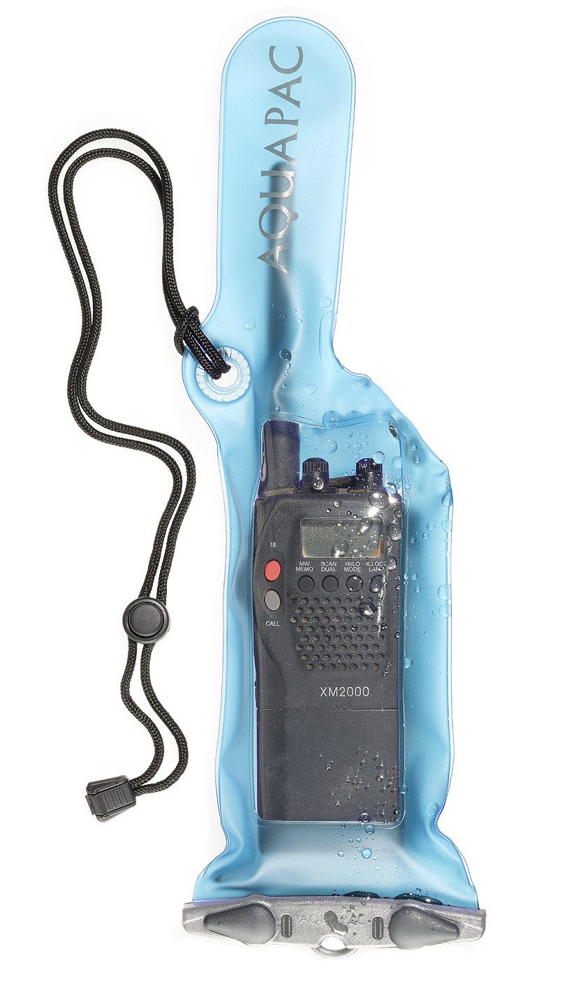

Whatever Radio you choose, I recommend one with a good waterproof rating. Then I place it in a waterproof radio bag like below and mount it to my PFD. No matter how well waterproofed electronics are, they mostly will die within 2-3 years of use in our wet salt water conditions (Island sailing) without additional protection. And in my opinion, the radio is useless if not in easy reach (mounted on you) and easy to use (one handed?) in an emergency.
