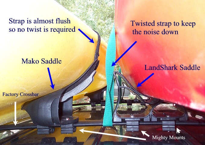

I'm not sure if I'm seeing it right but it looks like you have the kayak lying right on top of the crossbar with a pad under it.
This will cause hull deformation when you strap it down. You should get some saddles to mount to the rack and put the kayak in them with the bottom of the kayak in the saddle

IMO, your racks are too close together. I have an older Tacoma with a square tow hitch receiver. I bought an "extend-a-truck" L-shaped and T-bar, attached my yakima cradles to it and put a yakima bar over the cab with cradles. To load, I wheel the AI to the tailgate, lift the bow up and place it on the raised tailgate (with a carpet or life jacket over it to protect the hull), walk around and lift the stern while pushing it foreward to the front cradles, then swing the stern into the rear cradles. I would never load an AI upright unless there were cradles under it to the hull doesn't deform.

I've got the same truck (almost, a Frontier) and the same racks. I added the third rack over the cab (front doors). It made all the difference having three support points, as well as making it more stable up front.
To answer the question, I transport it right-side up, using the kayak saddles on the bow and stern. The bow saddles support the bow clear of the rack; the middle bar (the forward bar on the bed) has a rack pad on it, and the aft bar has saddles combined with a rack pad. Akas and mast ride sidesaddle on the rig as well.
