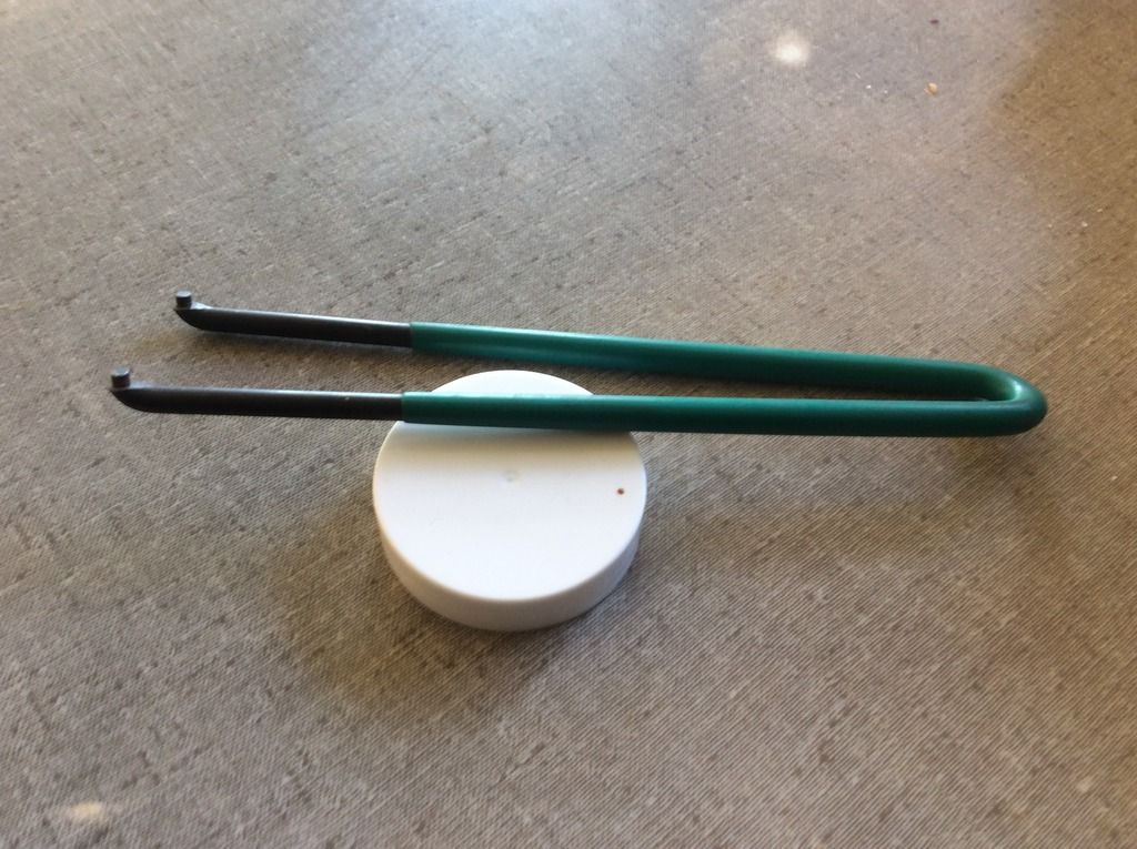

Hey All,
I found this tool in a bicycle repair shop.
It works great!

Great idea Don!
I have one of those Park pin spanners and never considered using it.
I'll be giving it a go for sure. Thanks!

Hey Stringy,
Thanks for putting a name on that tool.
Amazing ..... It showed in a bike toolbox I haven't opened in 35 years.

I'm thinking the snapring pliers would seriously tweak. (Maybe I'm thinking of a different tool ?).
The fittings are pretty tight. It's nice to have the leverage on the Park Pin Spanners.
They work great and are well worth a minor expense if you are replacing 'caps'.

Just tried the pin spanner and it does work well loosening tight fittings, but I wouldn't consider it a replacement for the Hobie tool. There are some hull fittings that have limited access and the length of the pin spanner becomes an issue. The rounded ends aren't an ideal fit either:
It does provide great leverage as Don says and is best used to initially loosen those stubborn fittings.
