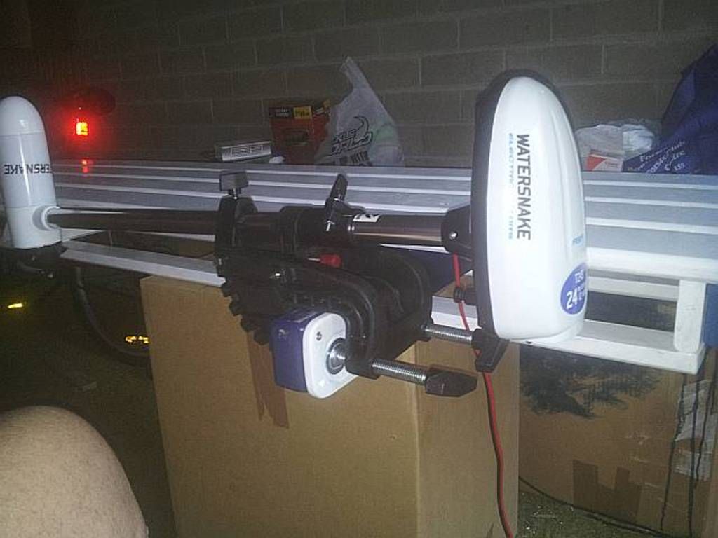

Funnily enough, the answerr is yes, buty stand by for something different... I have almost finished my Watersnake outboard mount >on the haka<. Here is an in-progress photo.
