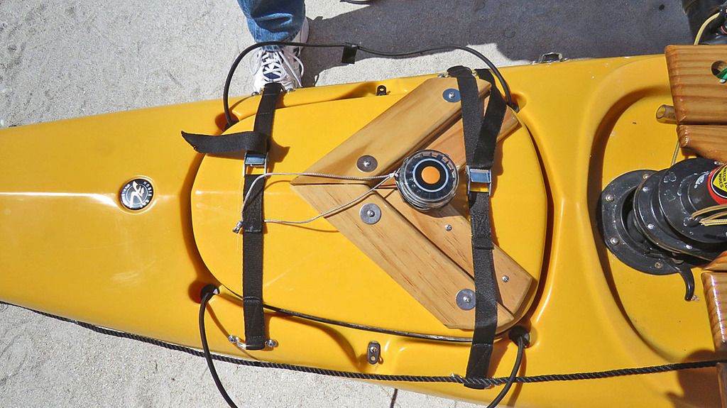

MrMako at last year's Everglades Challenge did have non-stretch cam straps to secure his front hatch cover. Note that the straps are near the ends of the cover and that the cover is re-enforced. Cam straps have another problem. While the exterior of the cam clamp is zinc coated, there is an interior spring for spring-loading the cam clamp which is ordinary iron and will rust and fail fairly quickly. MrMako will be back at this year's EC. I will be interested in all his innovations.
