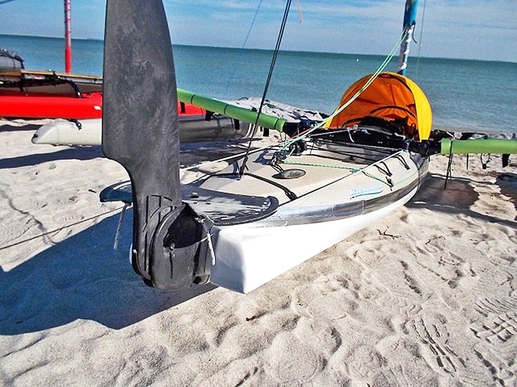

Here is a picture of a boat (stearn view) which was at the 2016 Everglades Challenge.
The owner also had a set of external rudder lines using a horizontal, black plate, which can be seen in the picture.

Thanks Chekika. That looks amazing.
