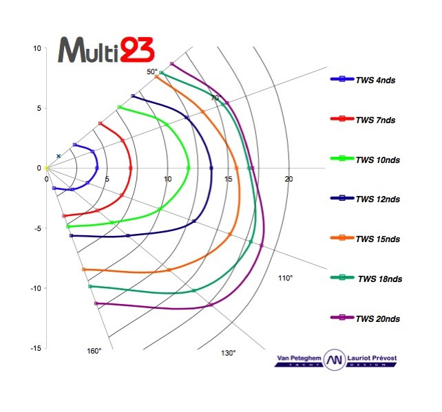

Yes, both telltales should always be flying, unless you're going downwind and using the wind to push against the sail rather than create lift.
Creating lift is always more powerful, which is why the really fast trimarans almost never go straight downwind. They can reach downwind faster, though the distance covered will be greater.
Here's the chart for a Multi 23. Note that the curves for each wind speed "bulge" a bit in different places, with the bulge drifting downward as wind goest up. The best angle for max speed depends on wind speed. It's more across the wind in light air, further downwind in strong winds.

I'm guessing that's because the stronger the wind, the faster the boat goes and the more the apparent wind shifts forward, so you end up going more across the (apparent) wind anyway.

Wow, how did you find that polar chart? I looked for a while trying to find one for a trimaran! Thanks for posting that! :o
Looks like we can gain somewhere between 10-40% in speed by falling off to 70 degrees, definitely will be something to play with the next time I'm out. Thanks again! :mrgreen:

I think that one came from the Multi 23 website. A friend of mine owns one, and I have raced it with him.
Remember that the AI is a very different beast from the Multi 23. While the general tendencies will be similar, don't expect that huge performance difference that a really fast tri experiences.

Tom, great chart for the Multi23. Multihulls definitely perform different than mono's. I crew on a Corsair 27, which can perform a "semi-planing" status. Looking at the Multi 23 numbers, it looks like it can hit about 17.5 knots. Best I have seen on my friend's Corsair is 17.4 knots at about the same angle in which the Multi23 can hit this mark. Do the Multi23s have the ability to achieve this "semi-planing" state? The Corsair, in theory, can hit higher numbers than 17.4, but I have yet to see this.
