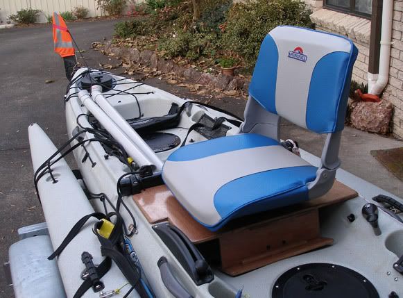

Tonystot - I see from your post you have a skipper seat installed. I too have one installed. I would be interested to know how you fitted yours. Mine feels quite high but is comfortable and dry. Under the front of my seat is secured a tube, this tube is secured to the hull with 2 saddle clips. Under the rear of the seat is fitted another tube, this rests on the hull enabling the seat to pivot up to access the wet storage area where the old seat rested. I'm OS ATM so can't attach pics until my rtn.

I opted for a simple solution, a 12mm thick marine ply platform spanning the hull and resting on both rails (I am a really big bloke (140kgs), with a support structure as follows. Cord loops at the rear attached to the crossbar suffice as "hinges" if I need to lift the seat.
Here is the platform, before I attached the seat
This also allows space below for a 2 litre water bottle, plus my "air conditioner" (a 500ml plant spray bottle which is extremely refreshing when the mist hits the face LOL)
