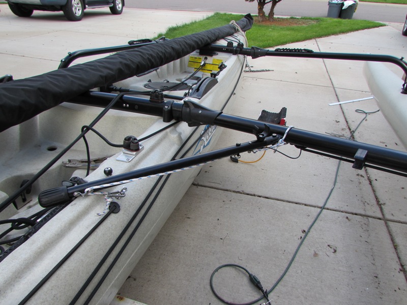

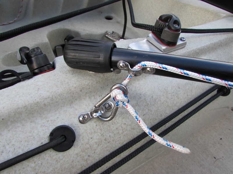

Here is a little different idea I’m going to try on a TI. The fast setup of the TI is one of the things I really like about it so I want to try and preserve this as much as possible. Also, I’m always sitting in the rear and need to be able to easily fold either side ama in for a particular lake I sail at.
The idea here is to put an eye strap on each end of the brace and then a line attached to the aka on one side and to the hull on the other side. If either the ball attachment or the nylon bolt break, you still have a captive rigid bar connected to the ama and the hull. It will allow the ama to collapse some but should restrict a complete collapse either forwards or backwards. When I need to collapse the ama, just remove the quick connect. I think this backup still needs some sort of "fuse", maybe just smaller line?
Im not done yet.. this just shows the idea..
PostPosted: Sun May 17, 2015 5:53 pm
Posts: 605
Location: Colorado
I mostly implemented this idea and did some testing.
First shot - all I have to do is connect the quick connect clip - thats it. If I want to collapse an ama, just unclip and pop the ball cap. The eye strap on the hull has a large 1/4 inch thick aluminum backing plate.

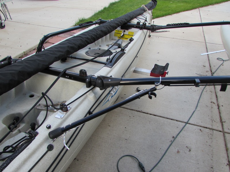

Second shot - other end of the brace

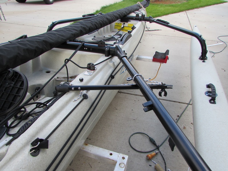

Third shot - I took out the nylon bolt to similate it failing and this is how far the ama will rotate forward

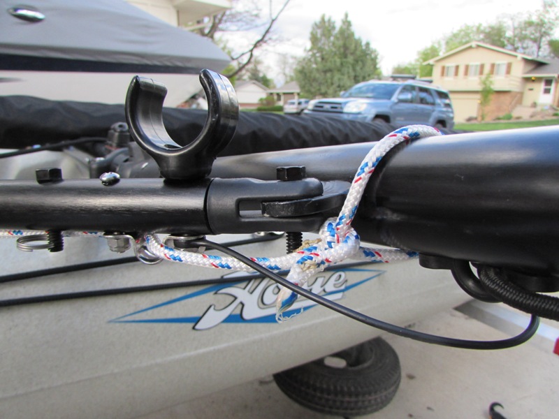

Forth shot - the nylon bolt is removed and the brace is popped out of the ball. This is how far the ama will rotate backwards
Fifth shot - this is with the nylon bolt in place but a failure at the ball connection.
Its not perfect but for how easy it is to use Ill take it. In the picture with the total failure of both the nylon bolt plus the ball popping out the ama rotate back "a ways" but once it reaches this angle its fairly rigid - wont collapse more and hopefully that is enough to give you some time and not end up capsizing.
