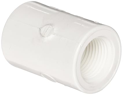

I made a simple adapter for the Hobie hand pump from a 1/2" PVC fitting with female threaded on one end. Just screw a short piece of hose into the threaded end and press fit the other end to the bottom of the hand pump. Works well to empty most of the water from the mast cup and rod holder wells after flooding with fresh water.
