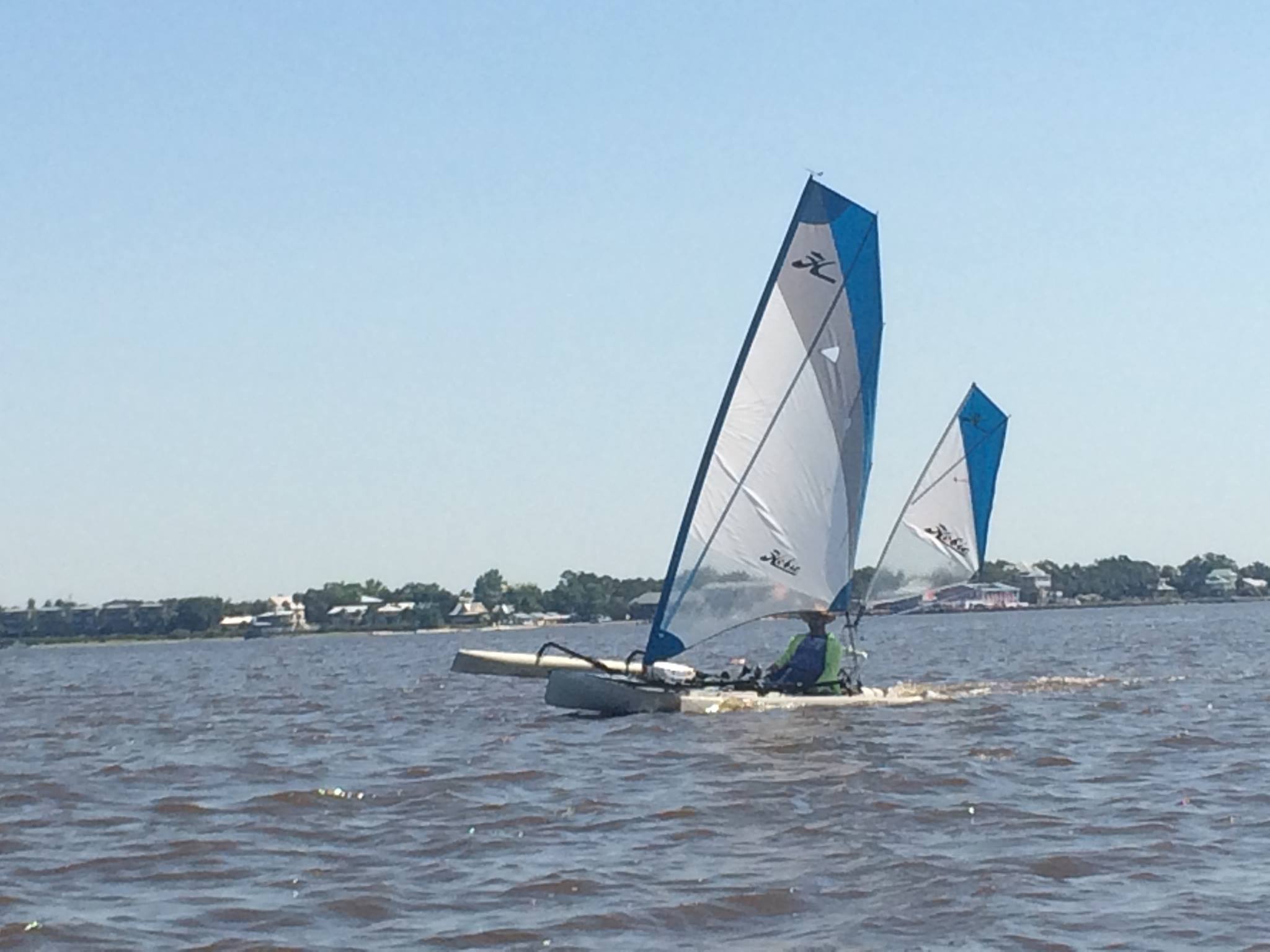

A Facebook friend posted this pic from the Cedar Key small boat meetup:

Tom Ray's photo from Cedar Key sure looks good! Sail shape appears to be perfect...
The whole rig just looks right.

I don't even care (much!) if it doesn't work; that looks darn pretty! Imagine the oohs and aahs if you bear away from the wind and add the Hobie reacher!

tony, most of the sailing that day was windward/leeward and every time I turned down I kept thinking "how sweet would it be to have the spinnaker out fly right now too!!!" I wonder if the mizzen would shadow the spinnaker.... my main thought is how awesome it would be to have the spinnaker to stbd, main to port an mizzen to stbd...
The rig performed FANTASTIC that day. the ONLY complaint is the flexibility that the PVC contraption allows. I wasn't able to sheet in quite as tight as I would have liked and I feel that when close hauled, the mizzen was not really helping much. I am considering adding something along the lines of a boomkin to help the sheeting angle some. As it stands, I just need to sail it several times to see what needs to be change because as it was, all things were petty.
