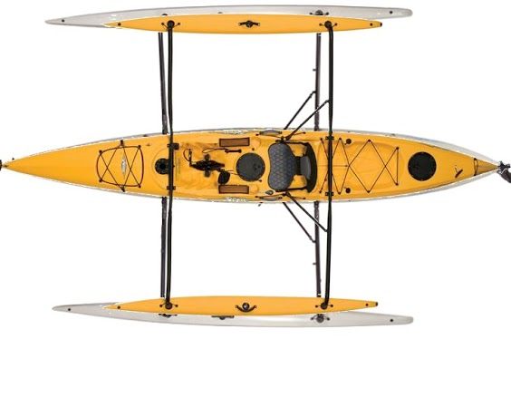

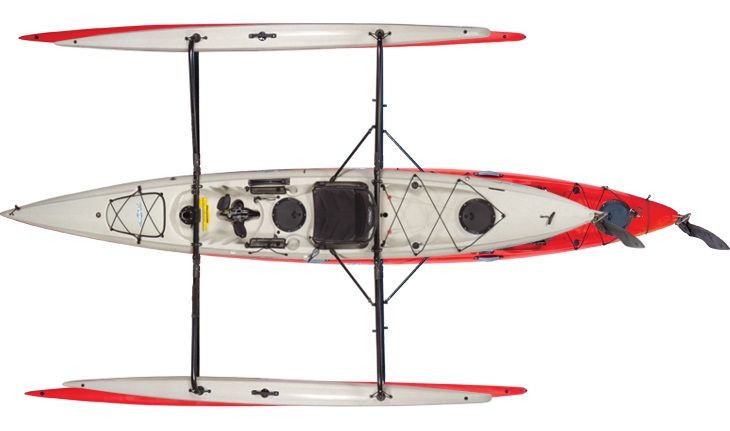

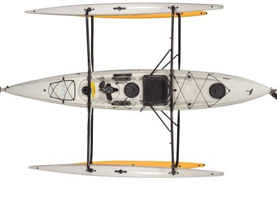

Here are Biagio's images:
Note that Biagio's "2014 AI" boat (yellow boat) is actually a 2010 boat or earlier (it has the old pin connector at the aka/crossbar joint and twist-n-stow rudder.)
Different people will see different things. Assuming that Biagio's images are to the correct dimensions, what catches my eye is
1. The ama's on the 2015 AI (dune boat in these pictures) have a distinct wedge-shape (inward slant) relative to the hull.
2. The amas of the 2015 AI make those of the 2010 version look positively puny.
3. The 2015 AI "swallows" the 2010 version when overlaid. The 2015 AI is "much" larger than the 2010.
4. The 2015 AI is almost as wide as the TI.
Stringy previously provided the following comparative specs for the 2015 AI vs the "old" 2014 AI:
Details- new (old):
Hull Length 16' 7" (16')
Mast 16' 6" (15' 2")
Beam out 2.9m (2.84) Beam in unchanged.
Sail Area -65sq/ft (57.5) (13% more sail area on the 2015)
Weight fitted 47.45kg (39.24kg) , rigged 64.4kg (52.16) (142# vs 116#) (22.5% increase in rigged weight)
Capacity 181kg (159) (400# vs 360#)
I'll leave it to others to speculate about what these changes mean in terms of performance of the 2015 AI vs the 2014. For me, time and usage will tell.

Thanks Blasius for taking the time to do the overlays and thanks Keith for reposting the pics.
Yes, assuming everything is equal (photoshopped TI?) it's a great way to compare the differences.
I see the same as you Keith.
Also it looks like the span between the aka has been standardised so that one set of tramps will fit both boats?
The seat location on both AI's seems the same? I thought in the show video clip it was mentioned the seat had been moved aft a bit? Looks like the rear aka has been moved forward?
It will be interesting to see if the new AI will fit the old cradles. Looks like TI cradles may be a better fit now?
Is this remarkable "toe in" built by purpose or is it a flaw in production?
