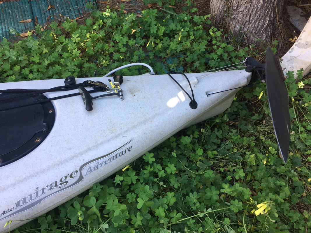

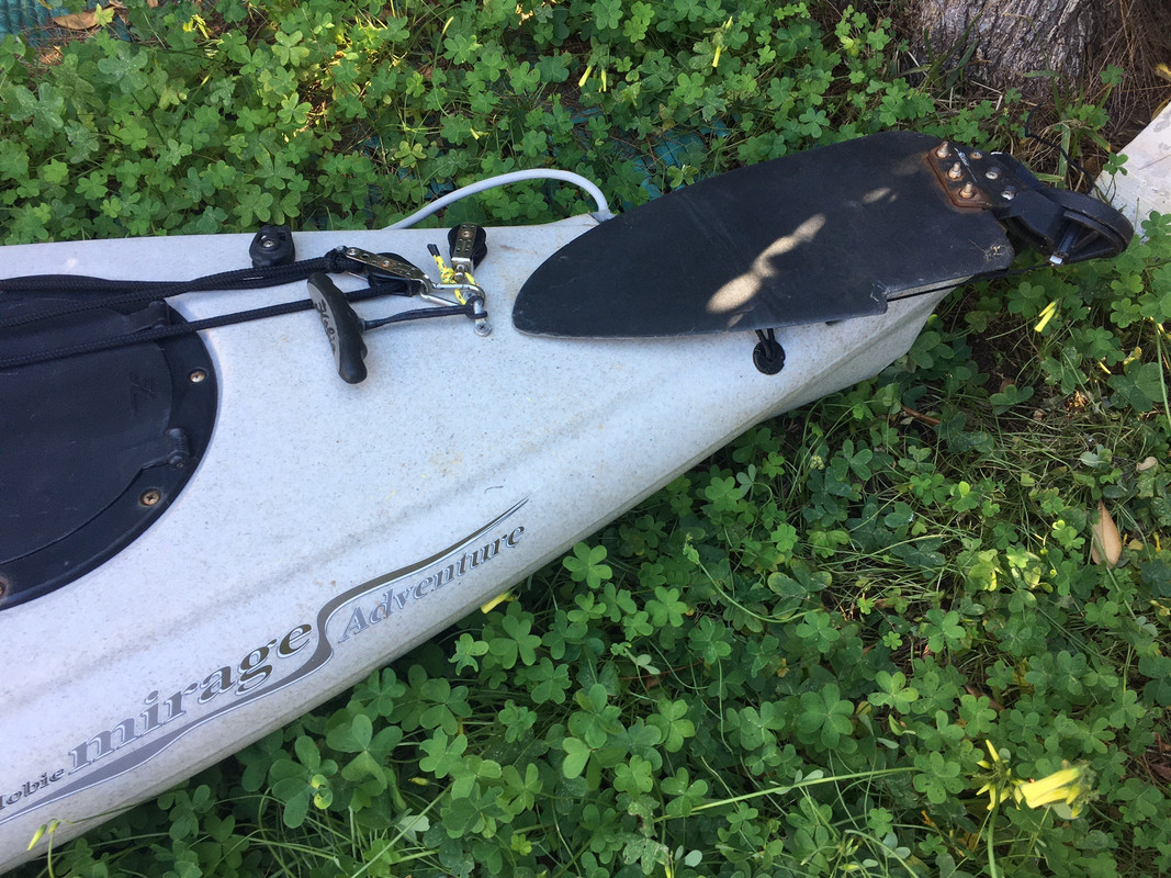

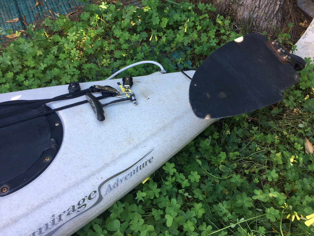

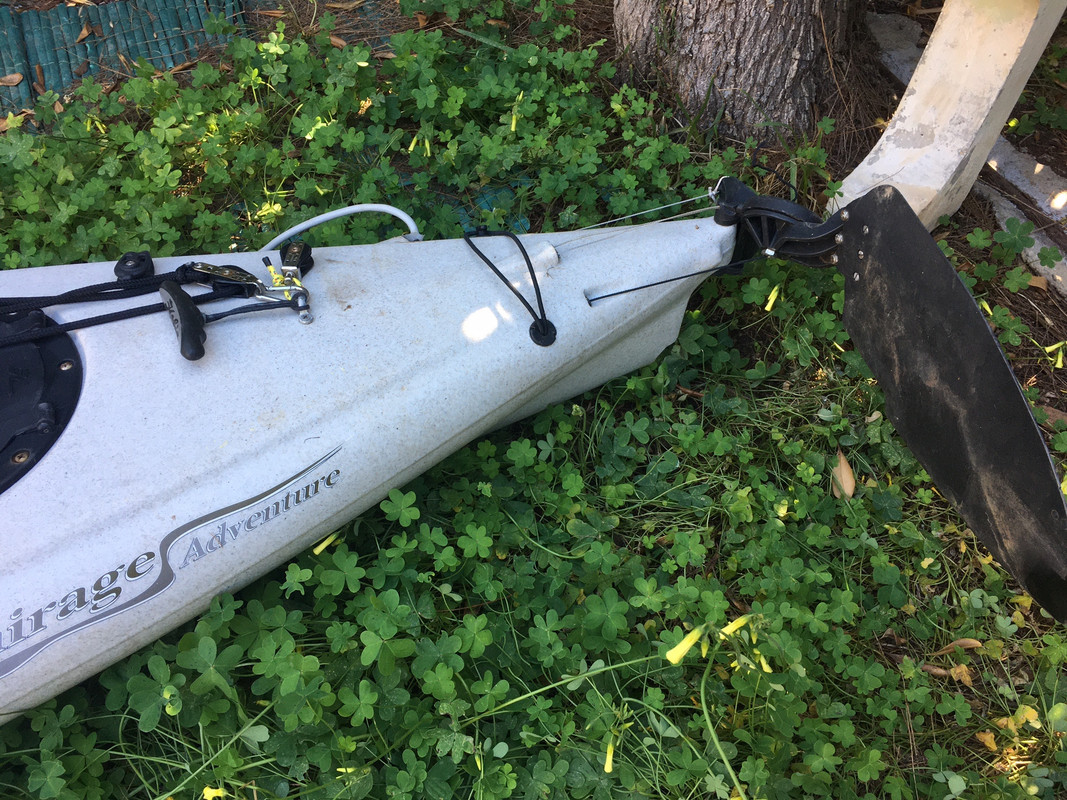

Here are 4 pics of the twist and stow rudder. It moves horizontally and vertically, than enters the water. If I mount the torqeedo on the left side, it cannot operate unfortunately.

You can still probably mount a 403 Ultralight. You will not be able to stow the rudder in the full flat stow position but that might not be that critical. You can just bungee it down on top of the 403 for stowage. The newer AI/TI's don't even have the stow flat feature, they just pull vertically up for stowage.
If you want to use Jim's mount for the 1103AC Ultralight but can't mount it on the left side, consider mounting it on the starboard (right) side. Which side you mount it on doesn't matter. I installed a right-mounted gas motor on the starboard side. It should be possible to mount an Ultralight or even a Travel series Torqeedo motor on the starboard side.
You can always just go with the Hobie Evolve motor as well.
There's always a way to power an AI/TI, you just need to figure out which option works best for your specific boat.
