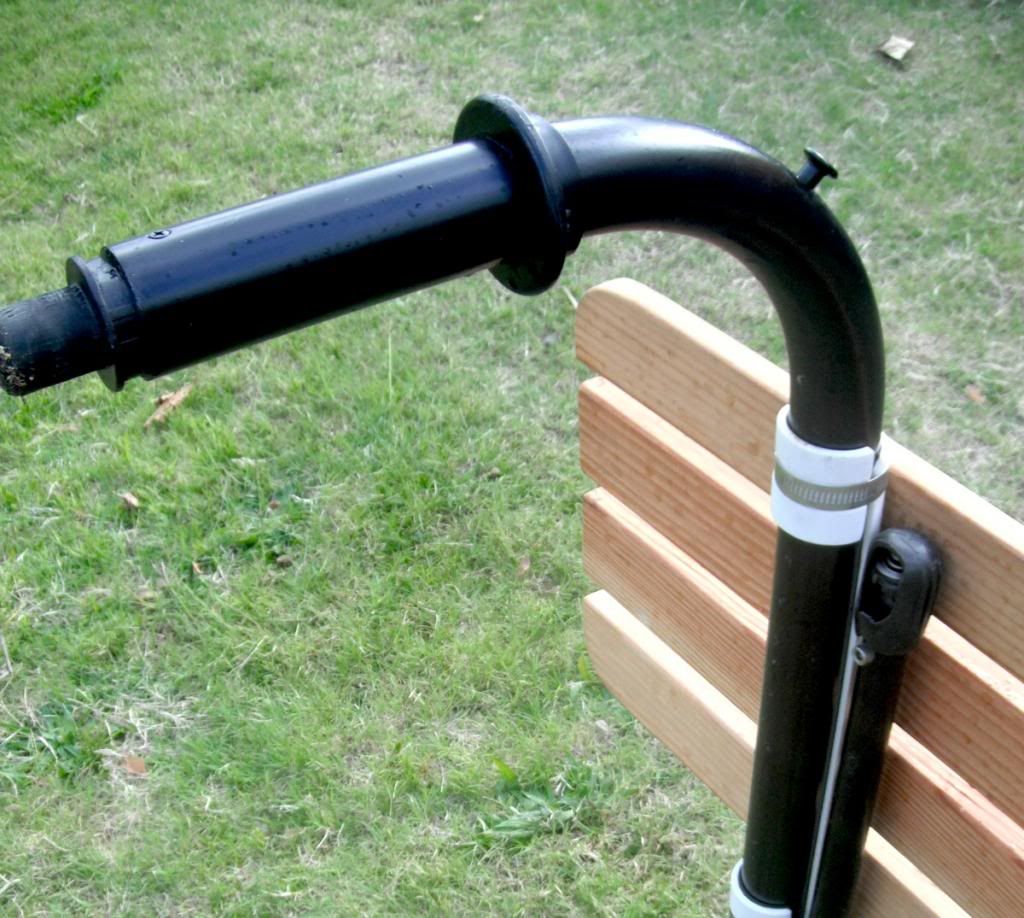

NOHUHU wrote:
For those interested - here's what the front and rear Aka extensions look like.
Post new topic Reply to topic  [ 40 posts ]  Go to page Previous  1, 2, 3
