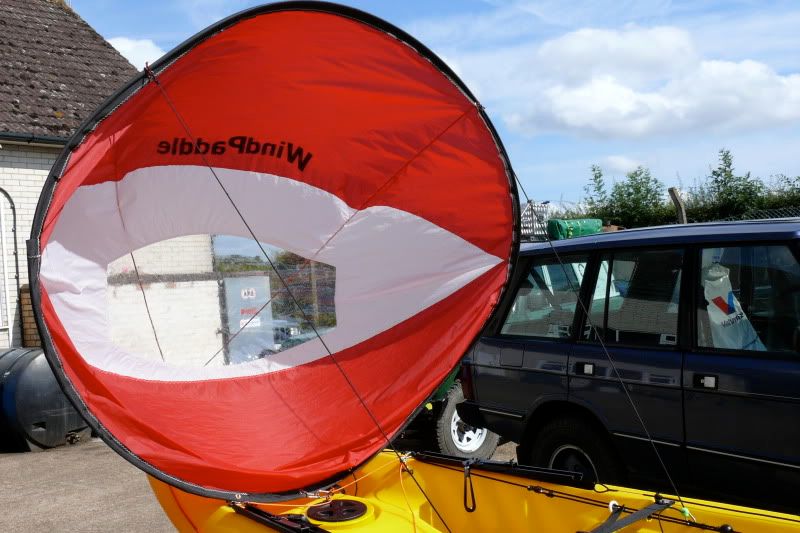

I have got a WindPaddle cruising sail (large one) that I use on my tandem O-K Malibu2XL.
It is very efficient on that and really gets it going down wind. Problem is that you need to get access to it to collapse it when not in use, which is not going to be easy with the mast in the way. I will have a look and see how well it works on the AI. It might be possible to run it to one side on one of the Amas Frames, which would mean it would be easily accessible without leaving the seat.

This is the windpaddle I will experiment with. It does occur to me that it would probably work well with tramps. If its base was attached to the forward Amas frame, the 2 control lines could be routed to the cockpit . The mainsail could be out one side and the Windpaddle the other.
When not in use, it could simply lie flat on the tramp under a bungee.

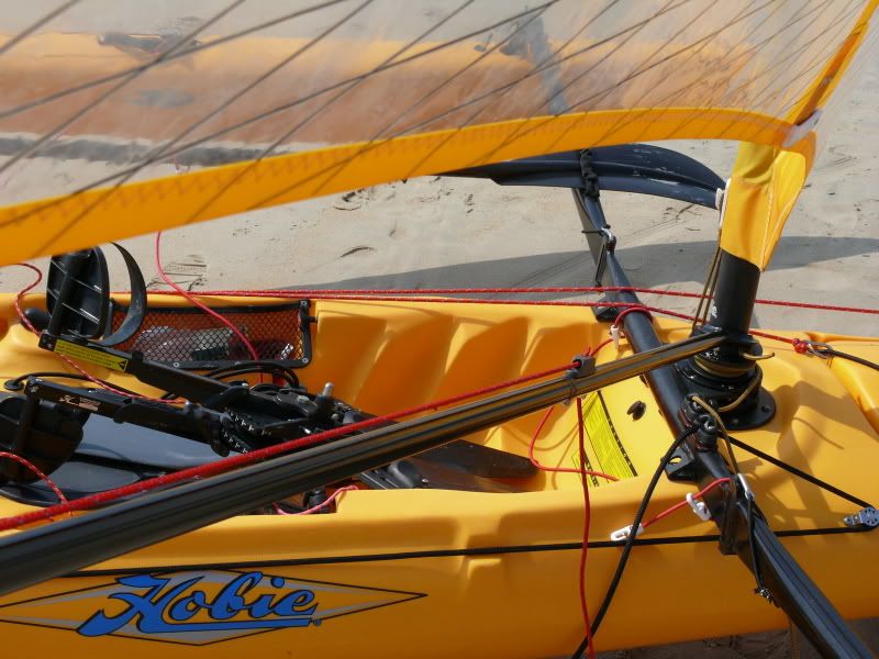

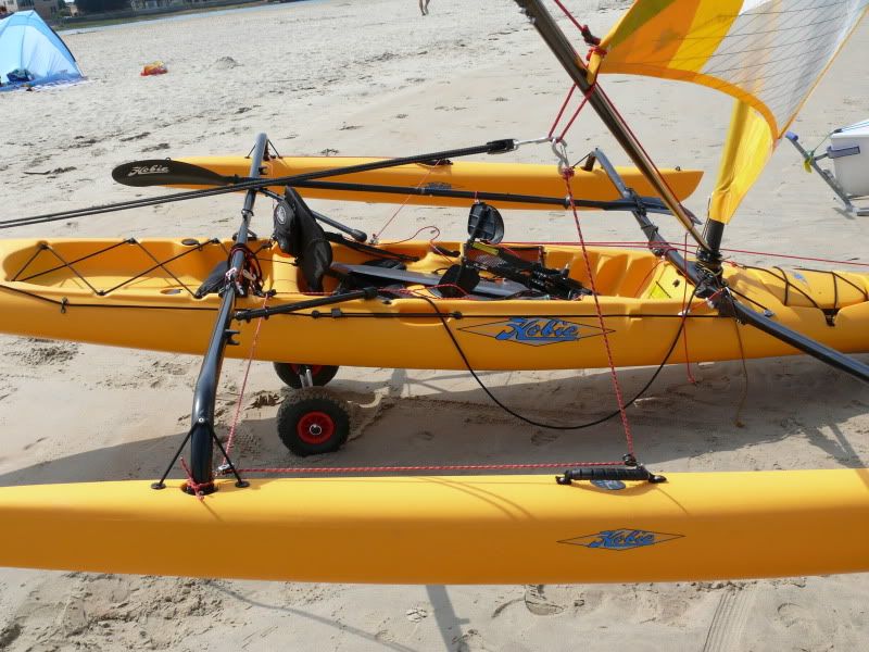

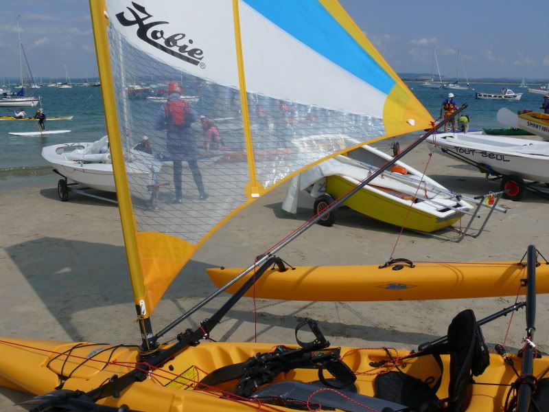

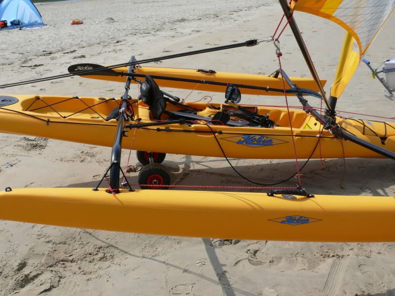

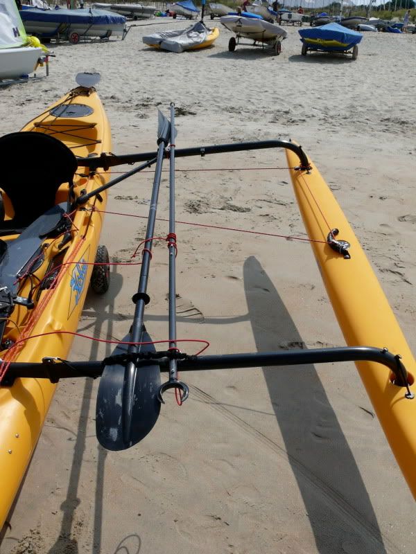

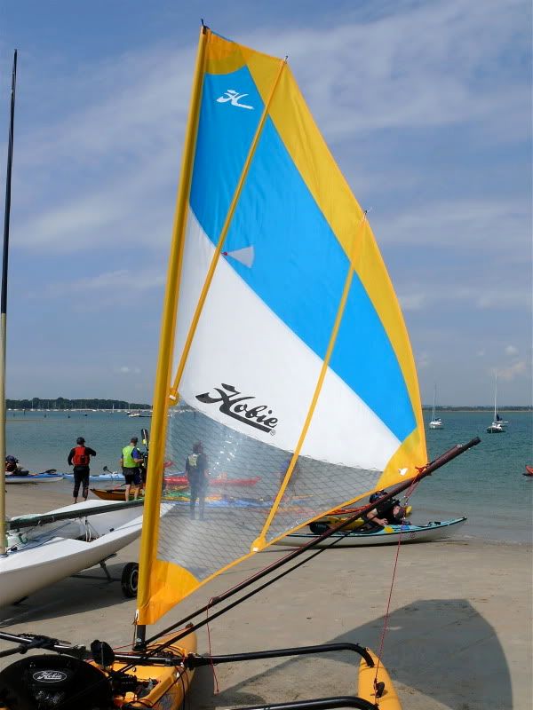

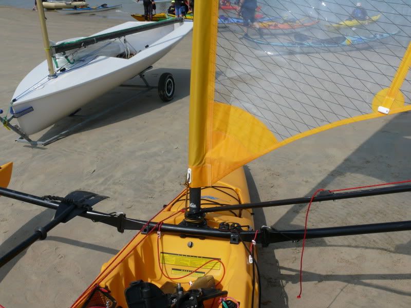

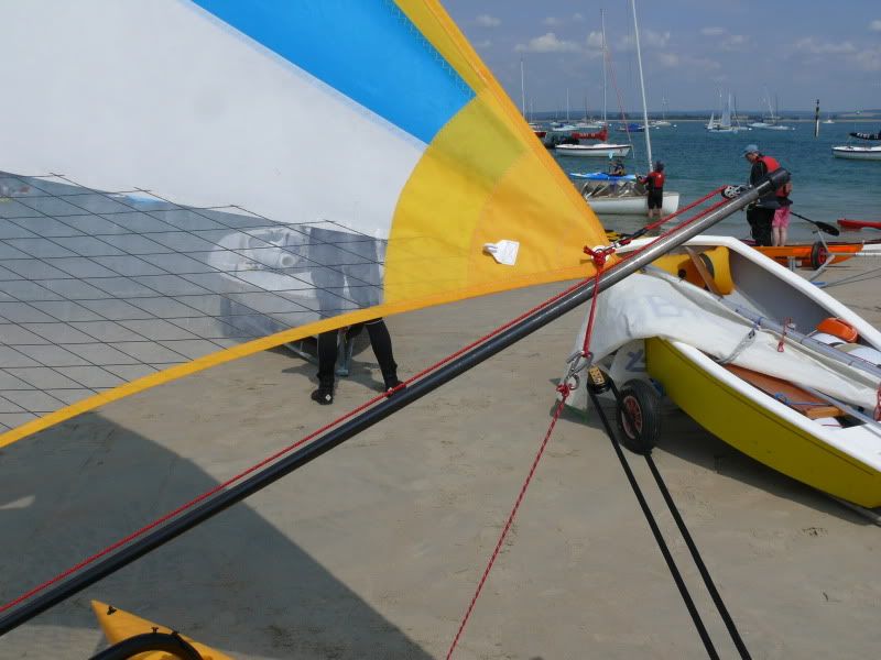

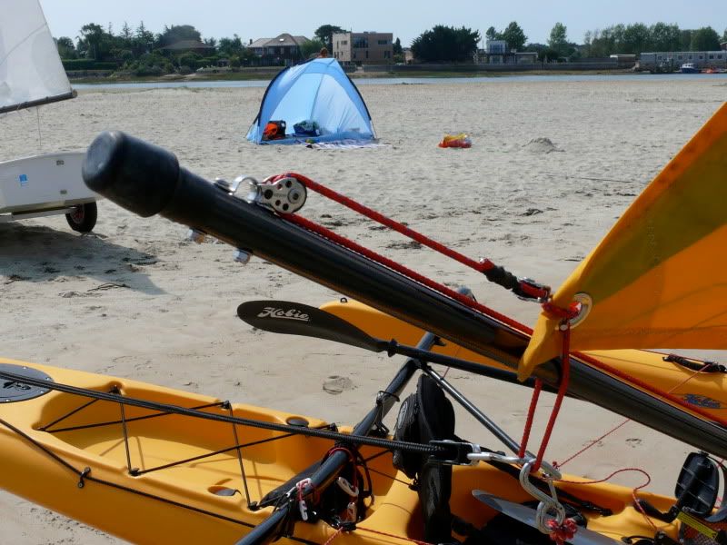

I have made a spinnaker pole out of a carbon tiller extension with a rollock that clips round the base of the mast and an out haul setup at the other end , that I can adjust to tension the sail. I have retained the Barber hauler which I am using as a kicker. This setup gives me complete adjustment and worked well in the little wind we had today. It is a bit chaotic at the moment, I need to tidy all the lines up and simplify the setup. I will take some proper pictures tomorrow of it all.
An unexpected bonus is that when going upwind, I used it as a boom and altered the sail shape with the outhaul. I think it pointed slightly better. I need some wind to experiment with.
I was tacking with the pole still attached with no problems, I believe this is worth more investigation.

Here are some pics of the spinnaker pole I have been trying out. It is a carbon tiller extension with an Oar rollock at the mast end and a outhaul pulley the other. I have still got a couple of refinements to do and will probably shorten it once I have established the maximum length I will ever need. I am also going to reduce the loop that everything hooks onto at the back of the sail. I have given it a couple of tests and it certainly makes a difference and being able to alter the outhaul means that you can stick the sail at at right angles and adjust the shape of the sail from dead flat to a nice scoop. I am using the barber hauler as a kicker to stop it lifting, so the end result is a very adjustable sail shape. I obviously still need to unclip the barber before tacking, but otherwise it all tack perfectly.
I have also been experimenting with it up wind. Not sure what the actual outcome is of that, sometime it feels as though it points a little higher, the jury is still out on that one.
