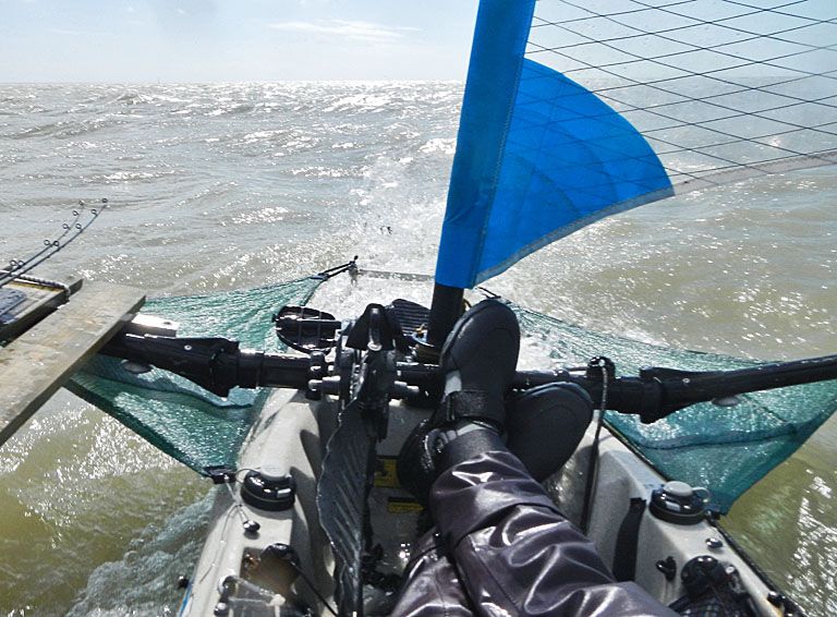

Here are a few of my pictures one day on our Feb 1-7, 2015, camping trip.
Preparation for serious diving by my 2011 AI.
Diving 1
Diving 2
Diving 3
Those pictures were all taken as we ran before the wind on a broad reach. I estimated the winds to be about 17-18 mph with higher gusts. We averaged over 5 mph for a period of 4 hours. More pictures of that camping trip and the rest of the trip story can be seen at http://www.hobiecat.com/forums/viewtopic.php?f=70&t=7276&start=645
A little side note, I never noticed any weather helm with my 2011 AI.

I don't usually see that much water over the bow, but I almost always get a couple cups of water in the hull.
Well I DO see that much water over MY bow, but I don't get a single drop passing the front hatch cover.
Half a cup from rudderlines and some very annoying leakage whenever I open a "Twist & Seal Hatch".
(Was that fixed on the AI 2015?)

Note that the waves are not so big (although a little bit bigger than shown on film!), but wind is quite hard and most of the sail is furled in. Speed constantly 10-13 km/h. (And absolutely NO water came inside the hull trough the front hatch!)
