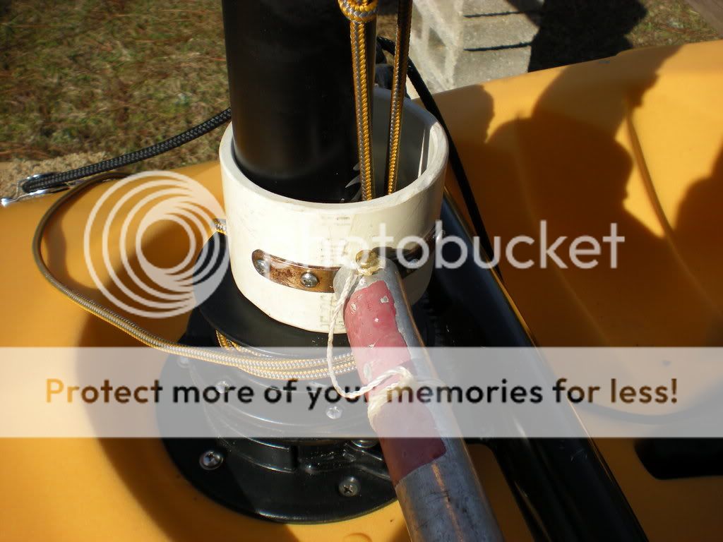

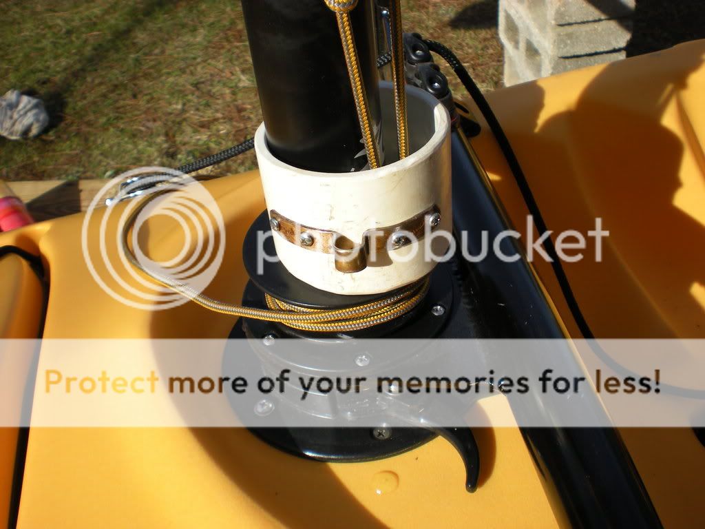

Looks very similar to mine. I simply used a piece of three inch PVC pipe for the base, screwed a small brass curtin holder to the pipe. Made sure the screws did not go completely through of course.
Then I attached the boom, or whisker pole if I only choose to use it for that.

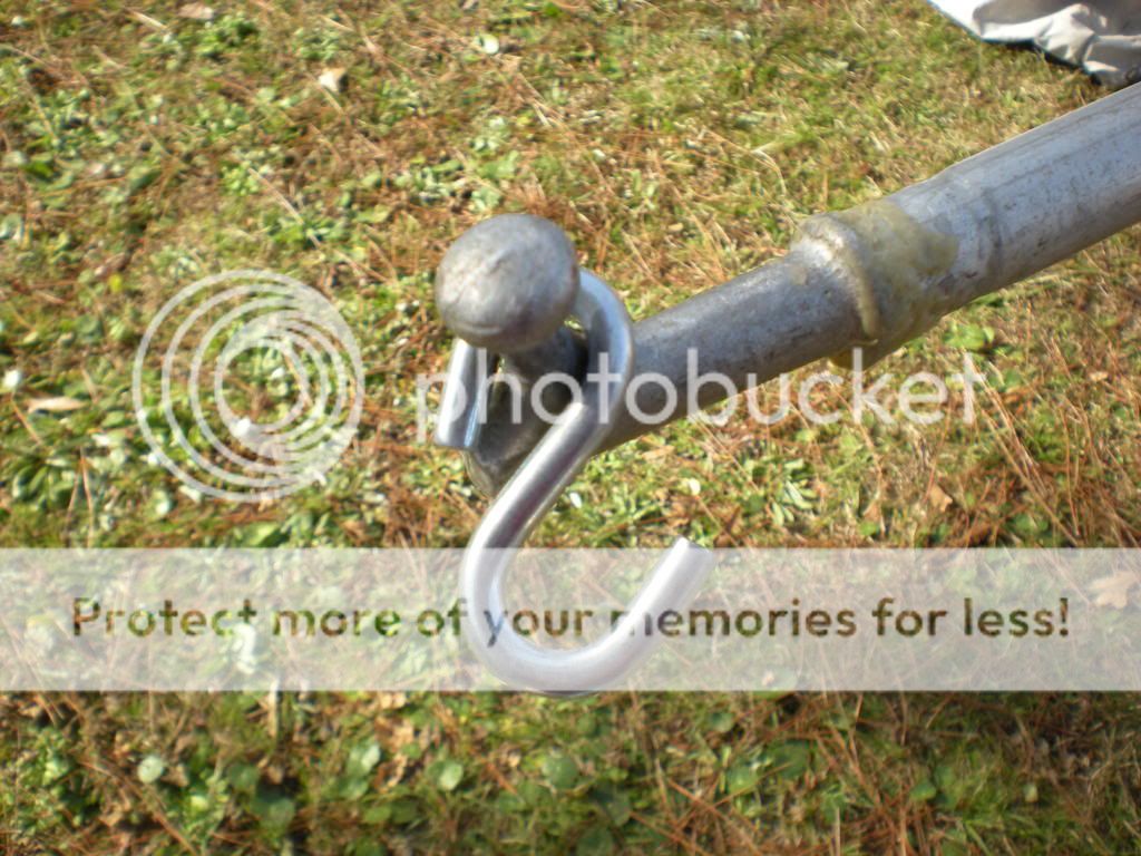

I simply put an S hook on the other end.
And the finished product.
Just finished it a couple of days ago but the weather has been too cold to test it. Perhaps by the end of the week the weather will be in the high 60s and I can get on the water again.
Notice I have a "bonker conker" pad right where it might hit my head. It is just foam from an old life jacket wrapped in duct tape. It will be replaced with a section of pool noodle when spring arrives and they are in the stores again.

Thanks for the post. Look realy nice and simple. do you intend to use this as a boom or as a whisker pole. If the former you may benifit from a longer piece of tubing to get the boom closer to the sail and give you for clearence for your peddles

Does your vang catch on your pedals, MRL?

No the vang as setup just cleares the top of the pedals and the toes. I am adding a simple vang retracter to insur it is out of the way when totaly rleased.
