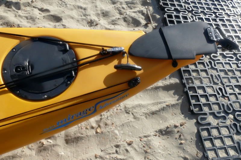

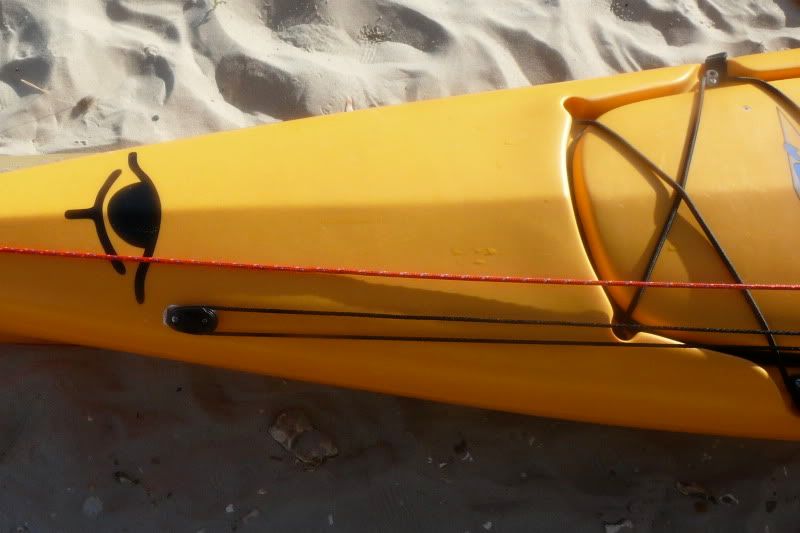

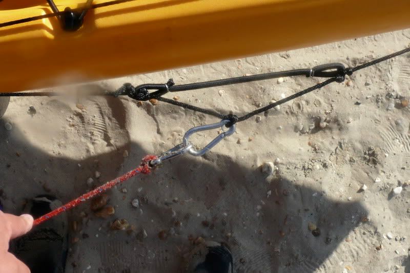

I have fitted mine. The bit that the video misses out and the instructions don't make clear, is what to do with the elastic and the hook. I have used the elastic to tension the lines and replaced the plastic hook with a stainless Caribina attached to the line, not the elastic. I have not fitted the eyes at this point. I have given the line a double wrap around the screw in cleat ahead of where the amas brace attaches to the pintle. So far that seems to offer enough grip to hold it when anchored. I don't want to drill holes if they are not needed and I use the elastic paddle keeper bungee to hold the amas into the hull, so do not want to remove it. I have attached some pics of what I have done below. Don't know whether this is right, but it seems to work ok.
Another mod I did whilst I was at it, was to fit a longer reefing line on the mast and fit an eye above the rudder uphaul to run the tail through. This makes reefing much easier as I am not having to reach forward to grab hold of the line. When I want to reef, it is close to hand.
