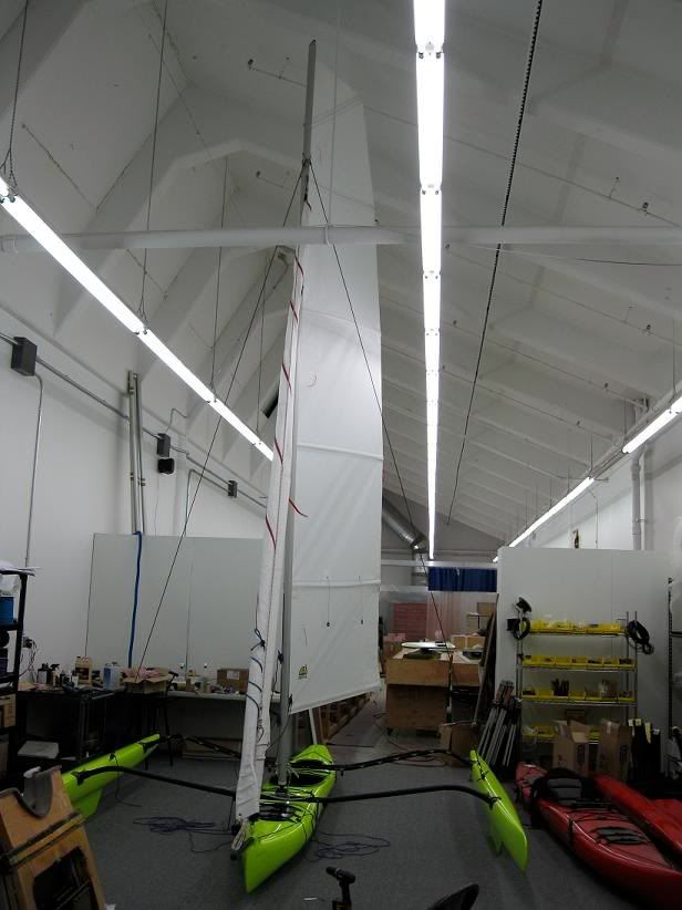

Here is a high-tech kayak trimaran. It is a beautiful boat with some design features similar to the AI.
Limelight is entered, along with a second boat, in the Mar 6 WaterTribe’s Everglade Challenge race along Florida’s southwest coast. The race organizers describe the race as follows.
WaterTribe Everglades Challenge:
The Everglades Challenge is an unsupported, expedition style adventure race for kayaks, canoes, and small boats. The distance is roughly 300 nautical miles depending on your course selection. There is a time limit of 8 days or less. Your safety and well being are completely up to you.
I queried the builder, Mark,
Chekika: I worry about one thing. The design of the amas is for speed. I worry that in a strong following wind and 2-3' chop, that the boat will have a considerable tendency to pitch pole.
Mark:
Ahhhhhhhhhh don't say that!!!
Actually, we've looked at the numbers and we should be fine.
This new masthead chute is big enough to turn the boat into a kite (or a submarine) in any real breeze. The recommendation is for single digit windspeeds only. I've already made the promise to my wife :-)
The wave piercing yet high volume of the bows has, so far, shown no tendency to bury. Part of the reason is that the boat is so light and the CoE of the sailplan in pretty low. The standard boat is about 70 lbs fully rigged!
It will be interesting...

I would be more concerned with the attachment points of the forward Aka's. It appears that the weight of the mast and some sail force will be at the center of the aka with a forestay and aftleading sidestays sharing the majority of the sails forces. Looking at the aka attachment point to the hull I only see two boltheads, I hope I'm wrong or they are really strong. The watertribe is famous for rougher conditions than practice runs I hope it all holds together. I'm sure the designers and builders know this and have go no go criterior.

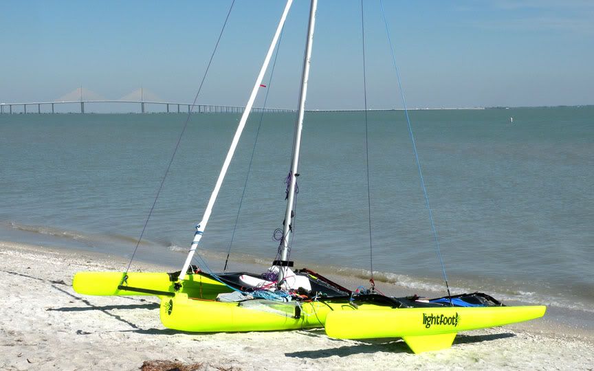

I went to the start of the WaterTribe Everglades Challenge. In addition to the 2 AI Tandems that were going to be in the race, I was particularly interested in the Warren Lightcraft trimaran sailing kayak show above. When I got to the beach (starting point) on Friday afternoon, Mar 5, many boats were in the final stages of preparation for the start of the race the next morning. Here is a picture of the Warren Lightcraft--it was simply pulled up on the beach as if returning from a sail. All other boats were above the high tide line--the starting point for Saturday's start. No one was around the trimaran for the next few hours. Hummm?
The next morning when I returned at 6:30 am for the 7:00 am start, the trimaran was nowhere in sight. Some bystanders told me that the owner of the boat had sailed it in some chop the previous day (apparently it was quite windy), and when he landed on the beach he was totally frustrated, saying that it was useless for the race since it continually submarined below the waves. I'm not using the colorful words the bystanders told me the owner used. This is all second hand information, but I can verify that the trimaran did not start the race. I was there.
