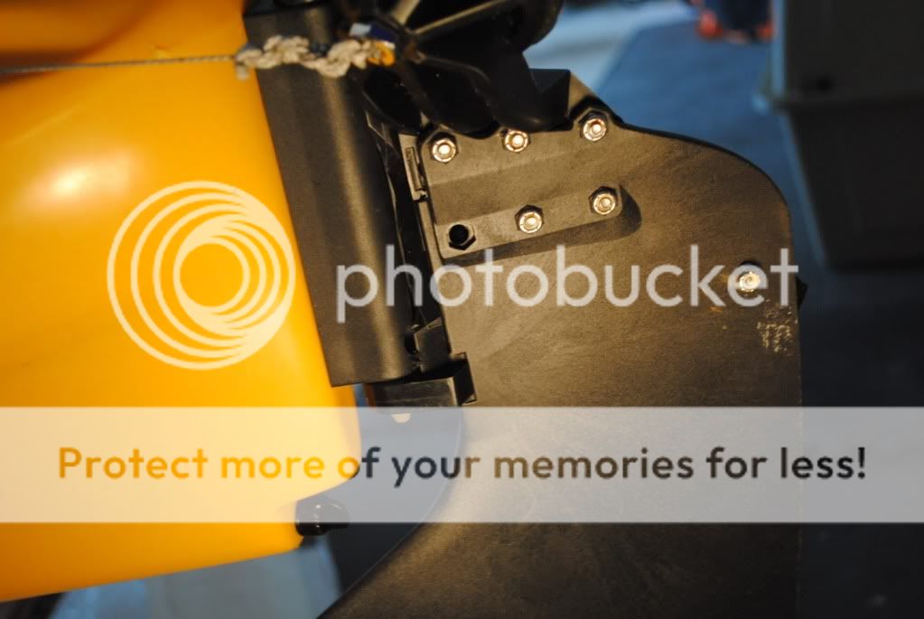

I photo-captured an image from the Hobie 'movie' of where the recommended
bungee holes are to be drilled.
After inserting the bungee through the holes...I checked the hole placement
versus both the captured photo and the photo included in the kit.
My bungee holes and bungee position were essentially identical with the photos!
Before installing the recommended bungee...I looked at the slot. There was essentially no space between the rudder and the starboard side of the slot...including the forward starboard corner. When I installed the bungee in the recommended location, the bungee sat tightly in the starboard vertical corner. However, since the rudder-slot fit was very tight with no room between the slot and the rudder, there was not room from the forward edge of the rudder to fit against the slot vertical face with the 3/16 bungee also in the slot! The bungee held the rudder out about 1/8 inch on the slot clip. I was back to where I was before the nylon bolt...with the rudder not being held fully by the clip.

The holes are in the lower / forward / right side (starboard) corner of the rudder housing... from the front just behind the rudder pin... and then exiting out the right side of the housing.
The shock cord should NOT be in the area where the rudder comes down and locks. If you drill at the wrong angle... it is possible that the bungee holes could pierce the area. That would be a problem.
These images should help clarify the drilling locations:
The drill holes are just behind the rudder pin
Out the starboard side
There should be no bungee in the area where the rudder seats.
We can send you another housing with the correct routing if needed.

I understand your frustration but to answer your question, yes I had a problem with my rudder popping up making stearing very difficult. I could not get my rudder to stay in the proper position using the rudder down cable. I even tried holding it in place while I pulled the down cable and cleated it off and it still popped up.
I just went out and drug the ^%$ trailer out again and took some pictures for you.
Here is the view from the starboard side with the rudder up. Sorry it's blurry but I think you can see the bungy cord and please note the hole slightly above it. That was the hole I drilled for my 1/4 inch bolt temporary fix.
Here is the view from the port side. This is the side that the rudder fits into. Please note that you can't see the bungy so how will it stop the rudder from going all the way in?
The next 2 pics show the rudder in the down position with the bungy holding it in.
