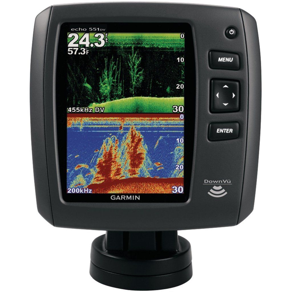

Like I said, I am thinking about getting the Garmin 551 dv. I do have a few questions, one of them is mounting the FF on my TI. Take a look at the base of the unit
The owners manual talks about drilling three holes to secure the circular base. The base seems a little large to mount on the TI. I would like to use one of the RAM mounts or something similar. Any ideas?

Here is how I mounted mine using RAM Mount products:
This piece is mounted on the gunwale.
This piece is attached to the base of the unit (holes are already there for this).
This piece is attached to the balls on the above pieces giving infinite adjustability.

So the above should work for the Garmin as the hole layout is standard? thanks, I appreciate the response.

It did on both of mine (gpsmap 441S and echomap 54dv). I think the pattern is a standard.
I originally bought this for a handheld http://www.rammount.com/part/RAM-B-138-GA14U so I'm not sure of the part numbers, but - I *think* these are the ones included in this kit (I used the RAM parts from this kit to mount the above units):
http://www.rammount.com/part/RAM-B-202U
http://www.rammount.com/part/RAM-B-238U
http://www.rammount.com/part/RAM-B-201U
