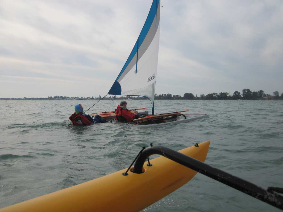

Has anyone heard what happened to this one? They beached on Anna Maria.
Just wondering how their boat came to be full of water.

Has anyone heard what happened to this one? They beached on Anna Maria. Just wondering how their boat came to be full of water.
My wife and I walked the beach late Friday afternoon talking with the participants and looking at all the boats and modifications. We noticed one boat that had the rear plug out and both ama plugs out and we both thought "how odd" someone would do that. Made absolutely no sense to me why you would leave those open unless you were actively draining water. But of course I wasn't one to tamper with anyone's boat and put the plugs in and the owners were not around to notify. Just one possibility how a TI could get that full of water !! Looking at the tracker, it appears they dropped out.
