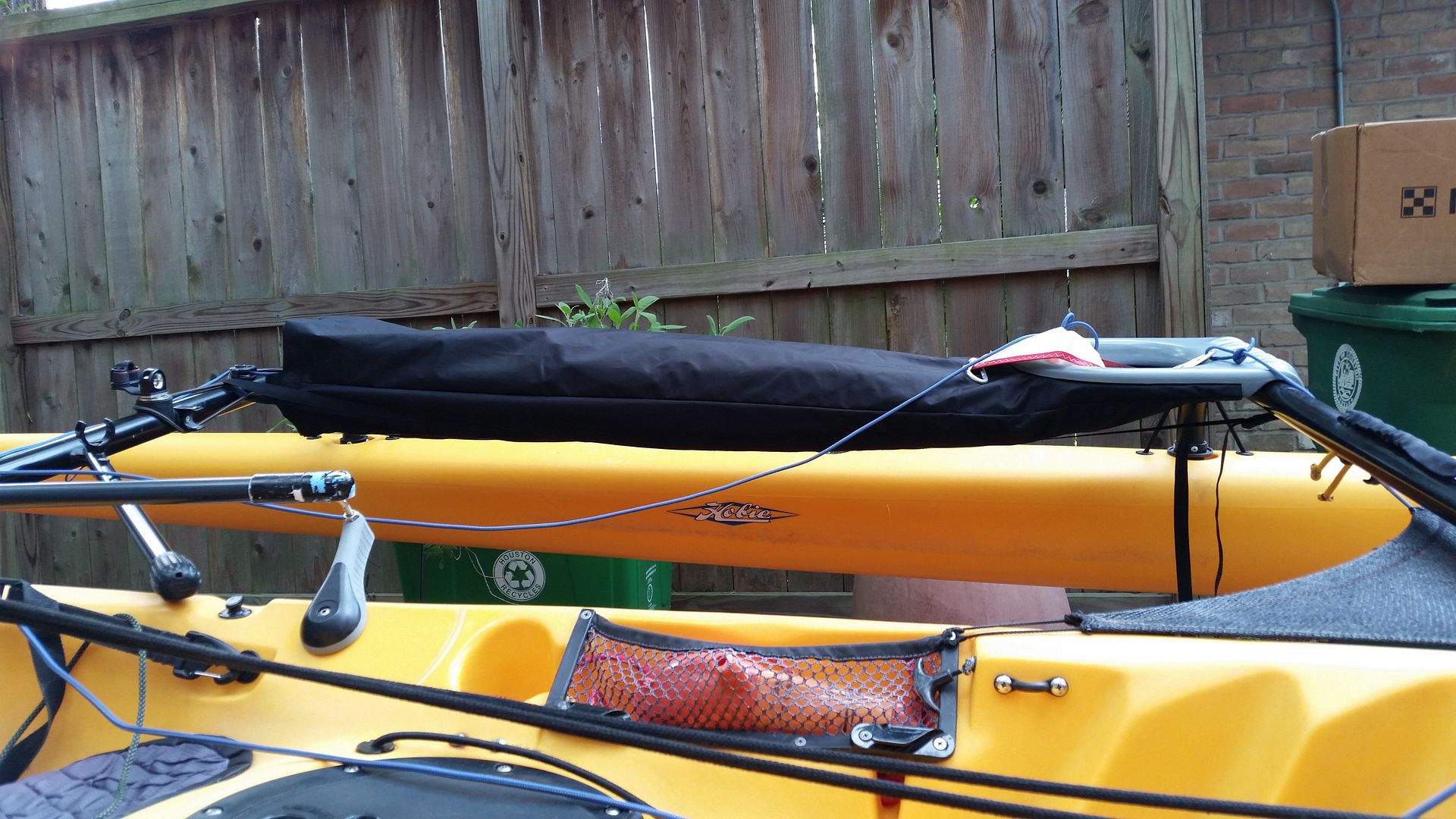

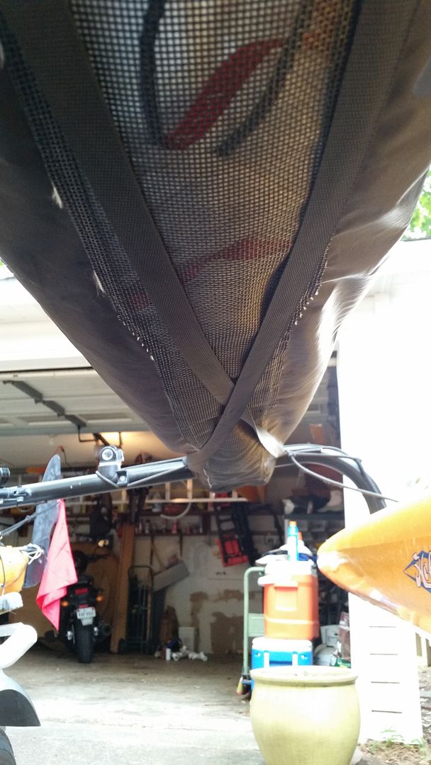

Anyone who wants to avoid a sagging snuffer can do so by simply crisscrossing the bags stirrups. This significantly levels the bag.
Holds level, even without the tramps.
