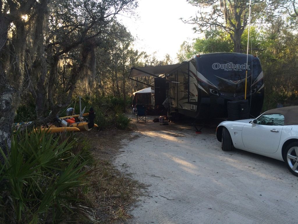

Here is our Camper (pic taken at our last outing):

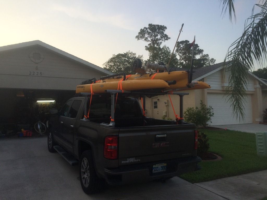

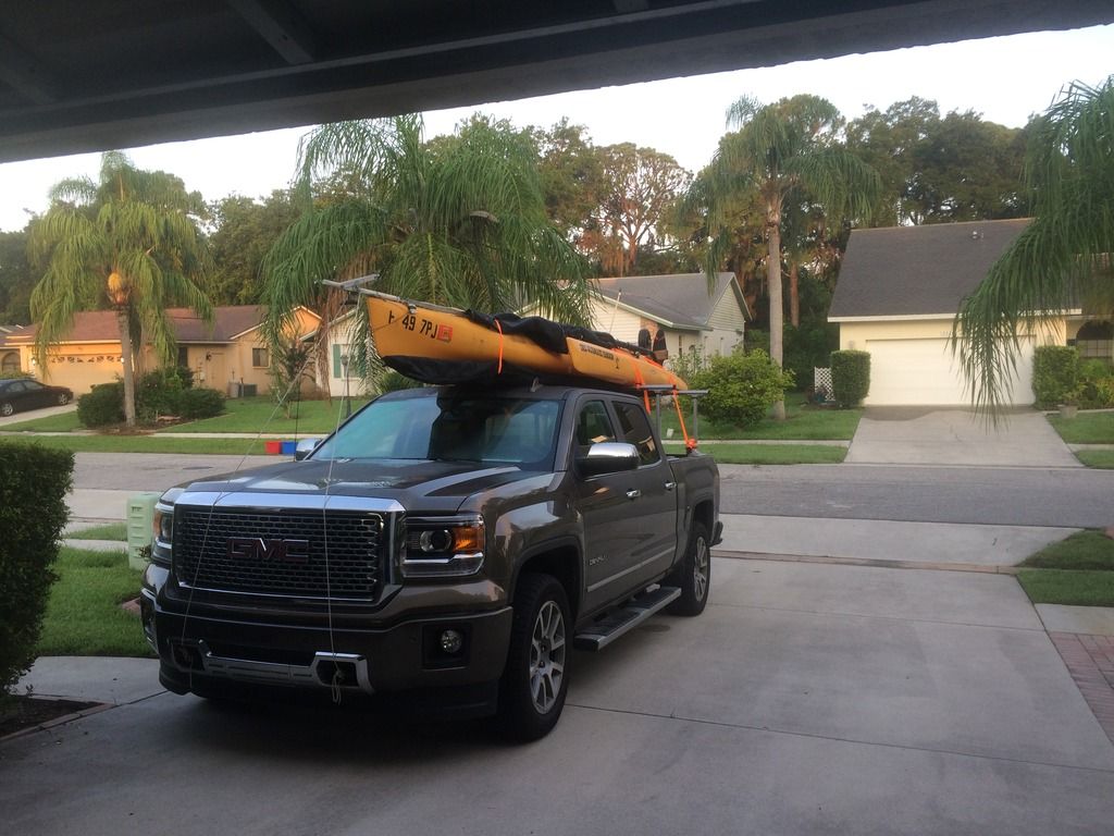

This is the current system I have:

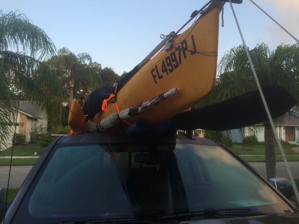

Notice the 8 ft vinyl coated wood closet poles that I picked up at Home depot (they were free because they couldn't find the UPC code at the checkout (their problem not mine) I waited at the checkout for 15 minutes, they finally just said, go ahead and take them (free), because they couldn't figure it out (lol)... They are perfect to support the boat on the roof, nice and strong, and distribute the weight perfectly. The poles are just laid into the grooves under the boat after I put the boat up on the roof. Notice the dirt on the bottom, that is left over staining from my planing hull mod that was mounted on the boat for a couple three years, now removed to make the boat lighter (about 8-10 lbs) so I can get it up on the roof, nothin wrong with it, it was designed to be removable, I just won't need it up at lake Hartwell.
The boat is extra secure up there (doesn't budge at all), and should survive the trip nicely. I loaded the empty bare hull onto the Thule Aero bars. It was actually not hard to get up there by lifting half the hull at a time (about 50 lbs lifting). I loaded it all by myself.
I then put the AKA bars and AMA's onto the boat (as good a place as any to store them). Of course they will be removed before I take the boat down.
All my massive sails are stored between the hull and AMA's and tied in nicely so they don't blow around.
The orange ratcheting straps I got at Home depot a set of 4 were $13 bucks, they hold 1300 lbs ea. and everthing is strapped to the lifting lugs in the truck bed.
I have a cut up pool noodle under the bow to prevent it from bouncing, and a V strap on the bow to prevent sideways movement. On the bow I used rope instead of straps, because on our old setup the 1 inch wide bow straps would flutter and vibrate in the wind on the highway.
