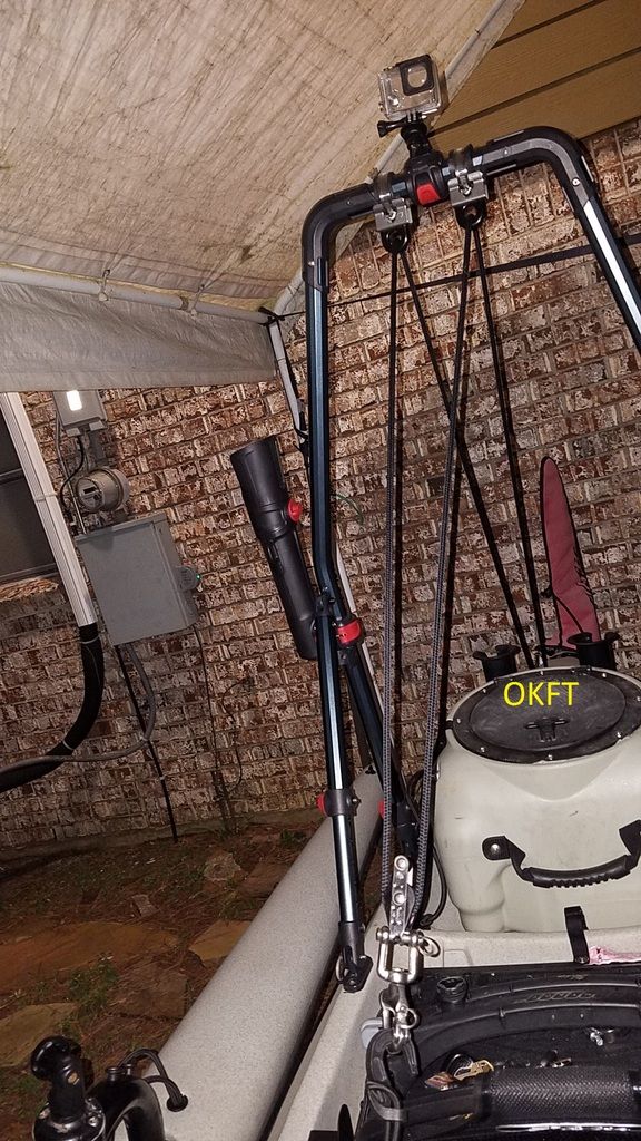

I use what I call the power tower. I have 2 fairleads on it to keep the main line out of the heads way. I've been using it for a year now no issues yet.
https://youtu.be/luS8xus6RlA
