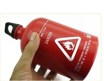

I am about to buy an outboard, and have been investigating extra fuel supplies. I am working on the "less is more" theory, and plan to buy (initially) one fuel bottle like this
The theory is that such a container would be quite light and easy to handle, with the idea that all the contents get emptied into the outboard at once, saving mucking around with funnels etc. If going away on a camping etc trip, I would also take a bigger (or second litre) container to refill at the end of the day.
I certainly have no plans to motor for a couple of hours at a time - I have sails and pedals if I need to cover big distances.
