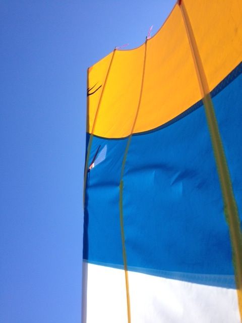

OK, here's a slightly reefed AI2 main in about 15 knots. Don't the wrinkles suggest too little batten tension?? This is really not a nice sail shape, so any help would be appreciated. :-)

At first glance it looks more like you're not sheeted in tight enough for the point of sail you're on and the front of the sail is stalling. But it also looks like when the first batten wraps around the mast that it might be introducing that 'S' curve on the second batten.

thanks Ti_Tom--it is definitely something to do with the first batten. Took these shots late last year, so maybe there's an issue of stalling. But what I remember is trying all sorts of mainsheet adjustments and not seeing this really poor sail shape disappear. Falling off didn't change anything except increasing the heel.
The mast is bending off a lot. It's supposed to do that, but is the sail capable of keeping its shape when this happens? I had a TI that I sold, and its sail didn't look that good reefed either. Maybe the roller-reefing does reduce your sail, but introduces problems with shape and flow as it does. Is this what should be expected??
I'm wondering if anybody out there has experience (or pictures) of an AI2 reefed about like this and setting up well. This sail has seen only light use for one season. Thanks for any help. :-)

Have you tried a lot of Downhaul? This can give more pre-bend to the mast and may take some of the looseness out. My mast seems to have a lot more curvature than what I see in your photos.

Can't fully agree that the first batten is not causing this. We are not seeing a flat luff up at the top like a windsurfer sail tuned with a ton of downhaul. We are seen reverse curves. If the first batten is too stiff and is bulging forward where it wraps around the mast, it seems like that could pull the sail into something like this shape.
I've shaved battens before on an H16, but they were flat--reducing the stiffness of a round batten progressively near the top seems like it would be harder.
