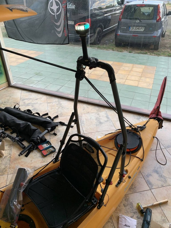

First option:
1 x 84500120 HOBIE H-BAR, OUTBACK
2 x 84500105 FOOT MOUNT, ANGLED / H-BAR
2 x 72020098 ROD HOLDER ASSEMBLY / H-RAIL
1 x 3275 Harken Double Bolt Down Fairlead 12 mm
1 x Radar Reflector
1 x 84501113 MOUNT ASSEMBLY / H-RAIL (from the H-Bar kit) for the radar reflector.
1 x 88991097 CHAFE PLATE, TI
2 x H233 BLOCK-MICRO CHEEK
And my second option with some RailBlaza parts. I personally chose the first option because it is simpler.
