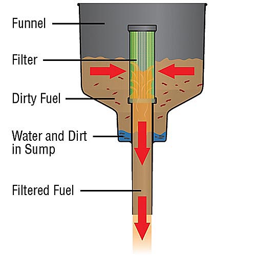

Jim,
I had fuel issues too when I was using a gas outboard. To solve them, I first switched to 0% ethanol gasoline as you have. I then used this product to filter out any contaminants and water which completely resolved the problem:
There are numerous YouTube videos showing the efficacy of this product. Small gasoline motors can be very fussy concerning fuel. This product helped me. It's especially useful in areas of high humidity where condensation can form in fuel storage tanks.
PostPosted: Mon Mar 20, 2023 9:22 am
Really good response, that filter would be great when filling the gas can at the pump. The huge underground storage tanks especially in humid florida are the likely source of the water.
To make matters worse ethanol is water soluble, and mixes with the water turning into a white jello settling in your float bowl, and blocking jets.
I always tried to use ethanol free fuel if I could get in in my outboards, however because the volume sold at gas stations is very low and is very prone to water contamination.
For this reason the filter you recommend is the perfect solution in my eyes.
As a private pilot, water was always a constant issue with small planes as well, sure wish someone had come up with this solution years ago.
I can’t count how many times and had to remove and clean the carbs, ( white jello) on my honda’s.
Great suggestion

Yes, the fuel filter is a good add.
I have the same filter.....but left it in PA for my Florida Keys trip....
The new gas (REC90) has been working great. No issues. Back deep into the Atlantic and Florida Bay. Still planning trips to avoid head winds where I can.
