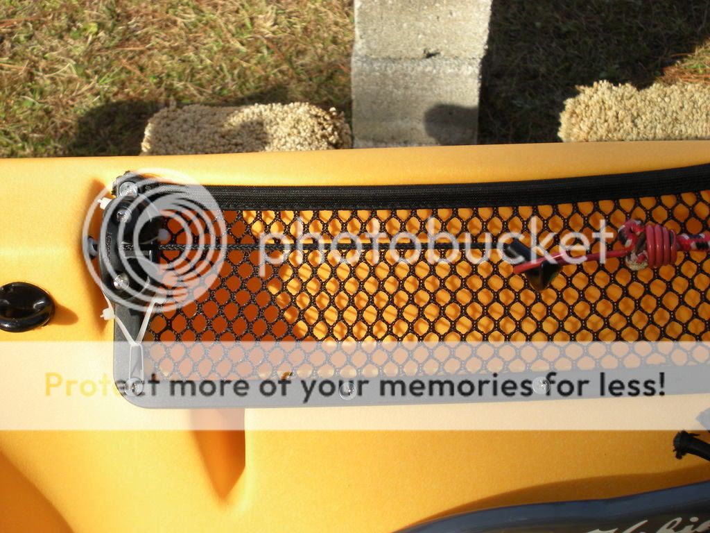

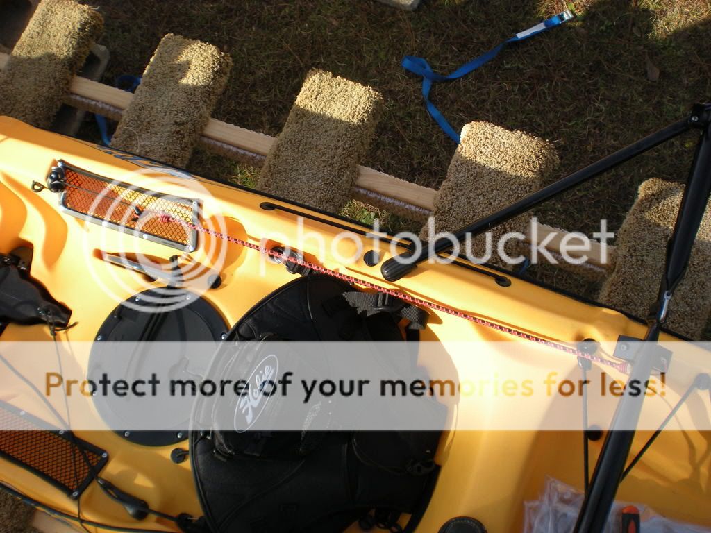

Way ahead of you Chris. I did exactly that a few days ago but the weather is still too cold to test it. I was going to wait until I tested it to post this but since the subject has been brought up I feel I must.
First I had to lock the cleat open.
And here is a close up of how it looks.
And the entire thing.
I used a two foot bungee. Tried a couple before I found one strong enough. Bungee's are not all the same strength. And you must have enough stretch left to go all the way back if required. This may not prevent the pin from breaking but it will definitely prevent it from breaking if I hit something.

One thing my setup will do is prevent such damage in the event I did break a pin and had to use a steel pin in order to get back in. If I hit something then the rudder would simply flip up instead of wrecking the transom. But rest assured I do not intend to use any other pin other than the Hobie supplied pin unless in an emergency. I will know by summer's end whether or not this setup prevents breaking or damage to the pin. Or, whether it even works at all. I am really anxious to try it. Oh for warmer weather.
