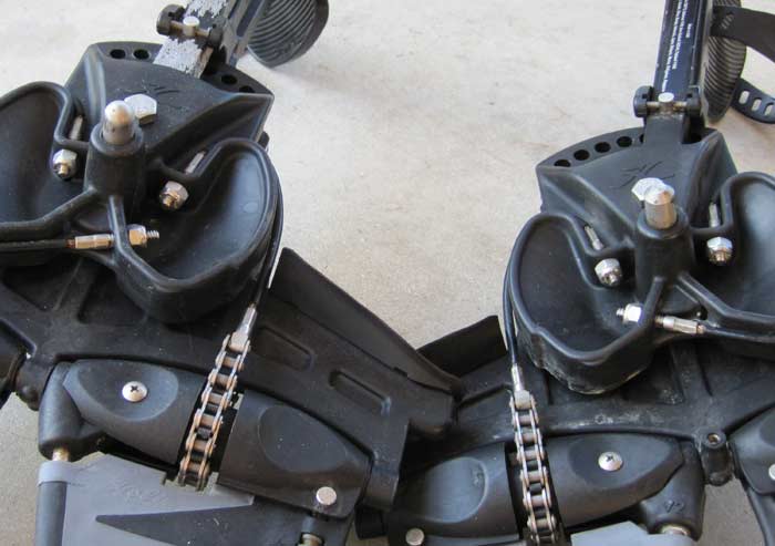

Thanks, reconion. This is the first time I have felt lucky to have lost my mirage drive in the creek. Mine was a V1, and was replaced with a V2. On the left, my wife's original V1 drive, on the right, my V2:
I assume the cut bevel rather than the rounded end means my shaft is splined and I'm good to go! :D

Yep, looks good.

It looks like your "V1" drive is an '08 model. I believe the splined drumshafts were actually phased in sometime during that model year, so it is possible that you have an early splined shaft. These early splined shafts had the round edges as well and are indistinguishable from the non-splined versions (without exposing the spline):
Top to bottom drumshafts: non-spliined; early splined, rounded tips; later splined, beveled tips.
Additionally, not all non-splined shafts spin in the drivewell. You can find out by etching a reference line at the top of your "V1" drumshaft and see if it rotates under use. If not, you should have no issues.

Thanks for the further clarification on the shaft thing, RR. I do not anticipate ever using my wife's drive in my boat, but I'll put a little mark on it and see if it moves. Her hull was manufactured in January of 08, so I'd guess the V1 drive dates to about then as well.

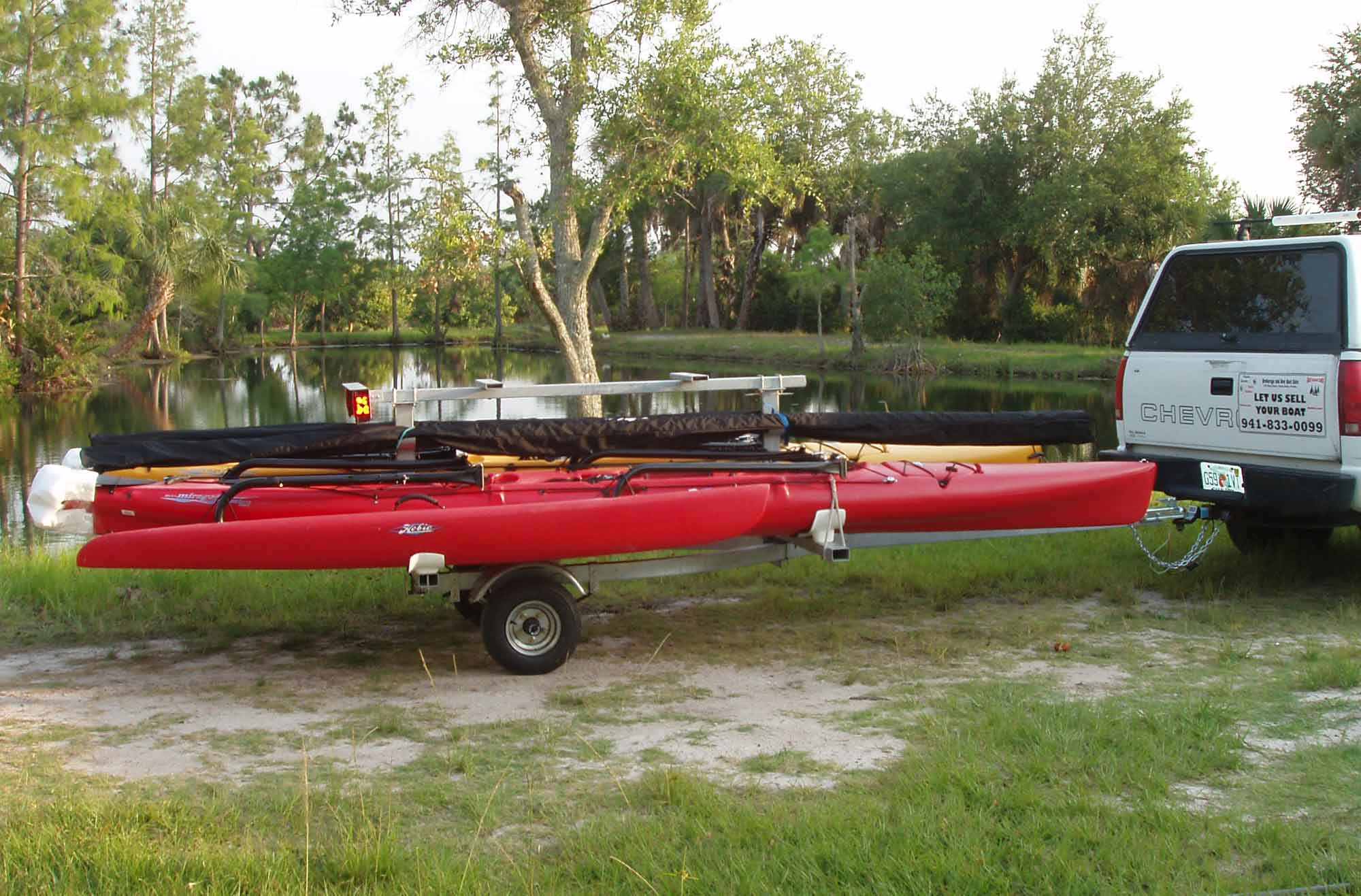

2007: just arrived in my yard, rudders still wrapped from the factory.

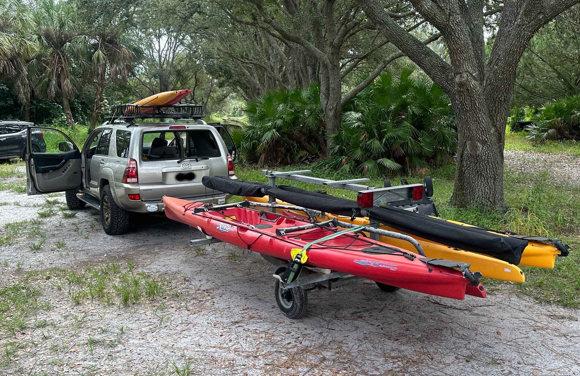

And over the weekend, headed out my driveway under new ownership.
