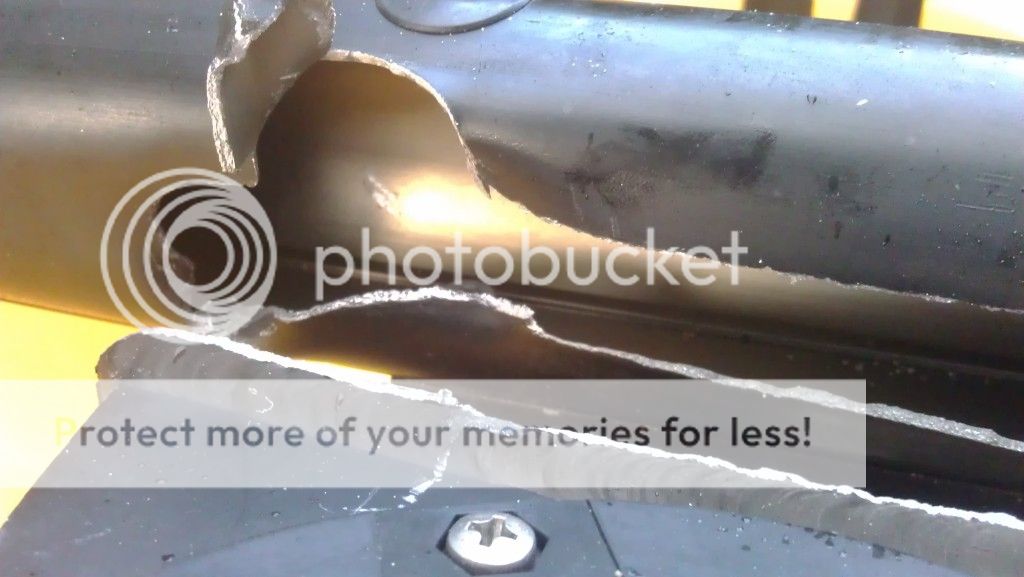

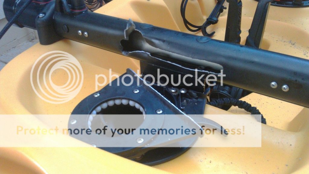

This happened on Sunday 5/27 . Luckily I was in the bay, by myself, and not out in the deep blue. I submitted for warranty at the local dealer. (2011 TI MODEL)
The last pic shows that beautiful weld . Something had to give and guessing its easier to replace the X-bar and Lower mast than it is to replace a cracked hull.

Kayakman7 I had sail out to 2nd or 3rd batten winds was 10-20 variable. I never checked or noticed anything wrong, it just happened. Earlier I had the kids on, good thing none was onboard this time. I think the mast will usually fall away from you. My reaction at first was to say "Hobie Spirit!!!" then you react. LOL Thanks

Being a Hobie Outback owner and planning on being a Tandem Island owner someday soon, I have been reading this forum with great interest. I have my two cents to throw at this topic.
My guess at the failure mode seems to be too thin of an aluminum tube to take the stresses induced into the weld to tube interface. Welding a thick aluminum plate to a thin tube can also be problematic.
Potential solutions to this problem would be:
1. Make the entire tube/bearing plated assembly out of 316 stainless
2. Weld a thicker tube section to the thinner tube to distribute the stresses over a larger surface area. I would also redesign the bearing plate to a dual sandwiched design to distribute these stresses to a wider zone. This would minimize the forces acting at the weld zones. See drawing concept at:

FlatK - it sure looks that way in these particular pictures.
It was a windy day for sure to have too much sail out, but other things should have happened before this failure. It's the kind of damage one would expect to see if you huli'd in surf and stuck the mast in the bottom, or drove under a bridge with the mast up. :oops:
Something ripped that XBAR a new one.
Guess Hobie should reinforce the lower mast too.

I know the TI only has the newer V2 akas, but I am curious to know if there is a difference in thickness between the V1 Fwd Xbars on the AI verses the V2 Xbars.
The impression I got in just looking at the 2 type of Xbars was the new ones (V2s) looked thinner, or at least looked less substantial - but I may be wrong, could just be the way they are shaped differently.
In the one picture above showing failure where metal is torn out of the Xbar it looks like the weld held and at least part of the metal failed.
Almost bought a TI, but wife and I having too much fun, each with our own AI.
Of course it would be wise for even AI owners to inspect all their metal on a routine basis.

The old AI XBARs are thick, but are "pinched" and welded at the pinned ends. This makes them even thicker and stronger there but not so much in the center, at the mast plate. Still, no real problems reported there on new or old AIs.
The extra TI sail clearly overpowers the early XBARS. It's also what makes the boat such a fun adventure.
