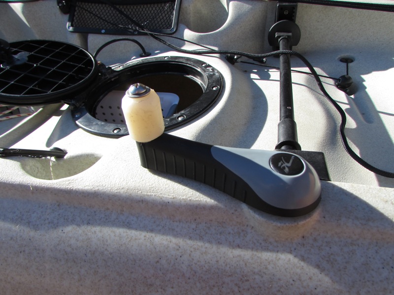

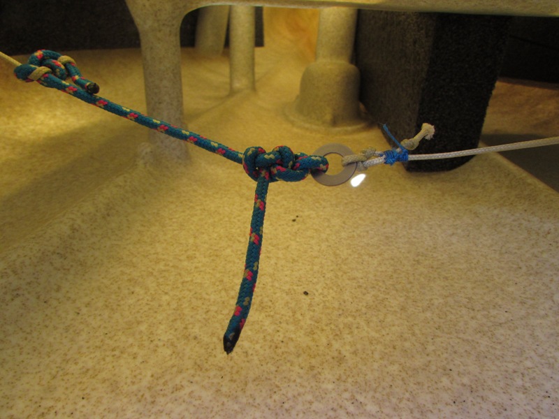

this post did help me.. my TI also had a tight rudder which was partly fixed by wd40 where it pivots but I have also had to mess with the limter as it restricted the steering knob a little more than I liked in the counter clockwise rotation. So.. I cut the line and found that without the limiter, the steering will over rotate counter clockwise. I dont think this is really much of a problem (just dont rotate it that far but nothing is damaged or stressed if you do) but I did still want that limiter in place, only a little longer. The access to all these lines is not real good.. The picture below shows what I ended up doing to make that adjustable.. (that is just a small stainless steel washer)
I used my "classic" AI for years with the steering completly stock from the factory but the TI steering is a little more effort so I also added a nylon post - real simple..
